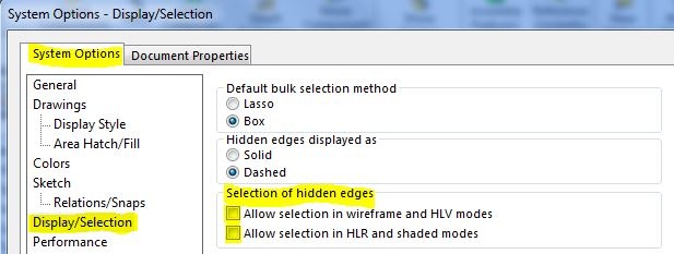

I dislike the Allow selection in HLR and shaded modes option because it becomes almost impossible to be sure the correct edge is being selected. I use the Allow selection in wireframe and HLV modes option, and have keyboard shortcuts to switch between wireframe & shaded with edges. For me, that makes hidden edge selection much easier.
Not that I know of.
