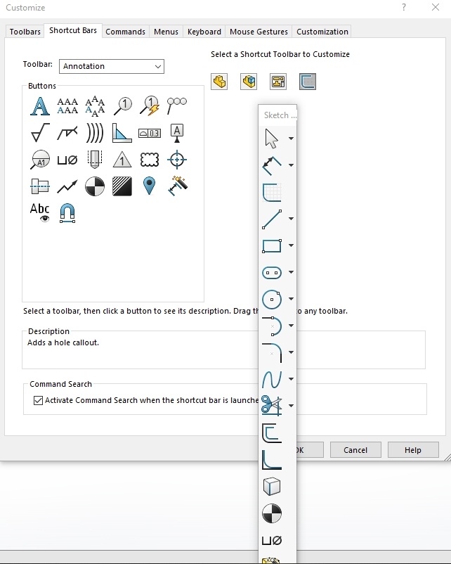

I find that since the installation of 2019 SP5, my Shortcut Bars are constantly resizing.
I start from a fresh reboot.
Open Solidworks
Go to Customize
Set the Bars to the shape I would like them to be.
Click "Ok" to confirm my changes
Activate the Shortcut Bars to confirm they have accepted the changes.
Close Solidworks
Reboot Computer
Open Solidworks
Shortcut bars May, or May not be correct now ... but rest assured ... they don't stay correct for long.
After several uses ... completely back to all icons in a long vertical row.
I have also verified that my Toolbars are set to Locked.
Here is what is I would like to have
Here is what happens.  This happens on all 4 Shortcut Bars.
The problem is, often when I press "S" to bring up the menu, the command I need it off the bottom of the screen.
So I have to hit Escape ... and move my mouse near the top of the screen and hit "S" again, so that the button is on the screen in order to use it.
Any Ideas?

FWIW, SW2018, Windows 100% scaling, small (default) SW toolbar button size, and I see this issue.  Never had my shortcut bars go to one long column but rather than 1x8 it would go to 2x4 for example.
JW
JW 2021-04-08
My guess is this problem is related to the size of the icons and likely a bug with the toolbar remembering its size relative to the icon sizes/DPI scaling (most likely DPI scaling rather than just the icon size setting). You have medium icons turned on, but in your image, your icons look larger than medium icons at 100% DPI scaling in the OS, so my guess is that you also have DPI scaling set to something larger than 100% in the OS. As a test, I would first set your icon size to small and leave the DPI scaling as it is and see if the problem goes away. If not, then I would suggest turning the DPI scaling to 100% with small icons and see if the problem goes away; I'm guessing it will go away. Then I would try DPI scaling at 100% and icons at medium and see if the problem is there or not. That way, you have individually tested icon size and DPI scaling to see if either of those is the problem or if it is a combination of the two that causes the problem. Of course, you can always ask your VAR to pursue testing these scenarios, but the tests should be pretty easy to do yourself (although maybe a bit annoying if you need the larger icons to easily see them). There is always the possibility that the problem is related to not only DPI scaling, but what icons you have on your toolbar and in what order they are placed; there could be some bug related to flyout toolbar buttons which are wider than regular toolbar buttons and it could be related to the order of regular and flyout toolbar buttons placed relative to one another.

Toolbar locking has NOTHING to do with the shortcut bars. The size of the shortcut bars changing without the user specifically trying to change them is a bug, plain and simple.
Toolbar locking also has nothing to do with the software changing the position of toolbars. As John mentions, this behavior can easily be reproduced if you have visibility of toolbars set differently in different document types and their positions conflict with one another. For instance, let's say you turn on the selection filter toolbar in parts and dock it at the bottom left of the SOLIDWORKS window and turn on the Line Format toolbar and dock it to the right of the Selection Filter toolbar. Now go to an assembly document and those toolbars will not be visible by default. Turn on the Line Format toolbar in the assembly document and move it over to the bottom left (don't turn on the Selection Filter toolbar). Now if you switch back to the part document, the toolbars will shift; either they will go on to separate rows or one toolbar will "push" the other toolbar to the end of the other toolbar. This is because only the visibility of toolbars can be different between different document types; not the position. And because it is physically impossible for two toolbars to occupy the same position, one of them has to move somehow. I believe Microsoft docking code is probably what decides HOW they move when there is a conflict. So no amount of "locking" of toolbars will prevent the software from having to adjust due to a physical impossibility.
Another limitation that I am aware of with regards to toolbars changing position is where toolbars added by third parties/partners through the APIs use old APIs (the easiest way to tell is if the toolbars from the add-in can't be customized at all through the Customize, Commands dialog). I've heard of and seen these toolbars causing things to shift around unexpectedly.
And, I am sure there are some bugs in toolbar code that can also cause shifting of toolbars unexpectedly, but during my tenure at SOLIDWORKS, I was never able to track those down.
