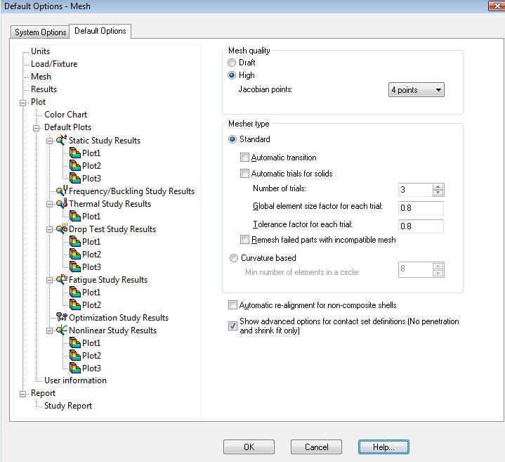

Hi Justin,
The most likely cause of this is the algorithm that aligns all non composite shell normals:
  • Automatic shell surface re-alignment for non-composite shells. When selected, the software automatically realigns the shell surfaces (non-composites) so that all bottom/top faces have uniform orientation. If this option is not selected, you may need to flip the misaligned shell surfaces manually. Select the desired faces, right-click the Mesh icon in the Simulation study tree and select Flip Shell Elements.
  • You can disable this option under Simulation options - Default Options - Meshing. Depending on what results you are looking at and the loading determines the importance of this. But as it says, you can go and manually adjust the mesh on faces to align normals too.
    Let me know if that helps you out.
    Cheers,
    Ian
    JS
    JS 2009-09-30
    hi,
    yes that works by unchecking it. also reaglined the top and bottom surfaces better than when it was checked.

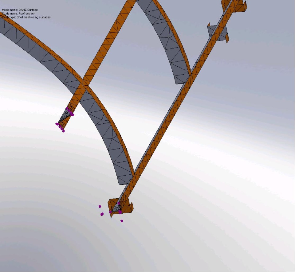

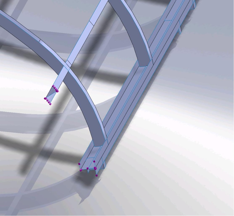

    Now on to the next problem which is when I mesh it one of the pieces dissapears, see the attached pictures. At the moment I have cut the body and the underframe and I'm just concentrating on getting the roof going with out any problems.
    SF
    SF 2009-09-30
    From my experience, the most common situation where parts disappear when you mesh the model is when the study gets out of synch with the model geometry.
    Try using the update components option (right click on the root branch of the study to get this selection) and then re-mesh the model.
    If that does not work, create a new study, and then drag and drop your settings from the existing study. Sometimes I find this a more reliable way of starting fresh, yet still take advantage of all the properties and setup from an existing study.
    Cheers,
    Ian
    SF
    SF 2009-10-01
    From your images, it seems that this problem could be easily solved using beam mesh, that would result in a simpler and ligher mesh, not to mention the significant improvement in calculation time and results accuracy. Have you considered that option?
