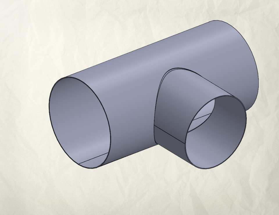

I have a 20" o.d., 3/16" wall sheetmetal duct intersecting a 24" o.d., 3/16" wall sheetmetal duct. I need to develop flat patterns for both parts.
My problem is when I create a normal cut through the rolled sheetmetal part a gap opens up. I understand why this happens but I need to figure out how to work around this.
It happens because the cut is made at the neutral plane of the sheetmetal. So the thicker the sheetmetal the larger the gap. I can work around this by creating a seperate model with sheetmetal thickness set to 0.001 to create the flat-pattern but this creates extra steps in the process. Does anybody out there have a better solution? The older sheetmetal workers in our shop can lay these out by hand and I have an add-on for Autocad that works great but I am trying to accomplish this all in Solidworks. I have attached the part file as well.

Ben,
I have ran across a similar situation and what I've done was to create a plane for the length of the tap, a sketch to drive the angle of the tap, and then offset from surface for the tap (see attached ZIP file).  This is how we are producing taps here at my place.  The cutout in the larger duct is an extruded cut from the ID of the tap.  Let me know if this will work for you.

Thanks Steve,
This works o.k. when material is thin and tap size is much smaller than trunk size.
You still run into the same "gap" problem when the tap size approaches the trunk size and the sheetmetal thickness increases.
You only see the gap when you set "normal cut" to on in the cut properties. This doesn't have to be set to on, but when the flat pattern is generated it is effectively set to on anyway.

See if this works for you.  The cut in the larger pipe is made with an ellipse going from the inside diameter at the horizontal location, to a predetermined location (considering what a “normal cut” would look like) from the construction geometry in Sketch1 in the vertical location.  I would not want to recreate this every time I needed a new T, but I believe the idea is what you are looking for.
