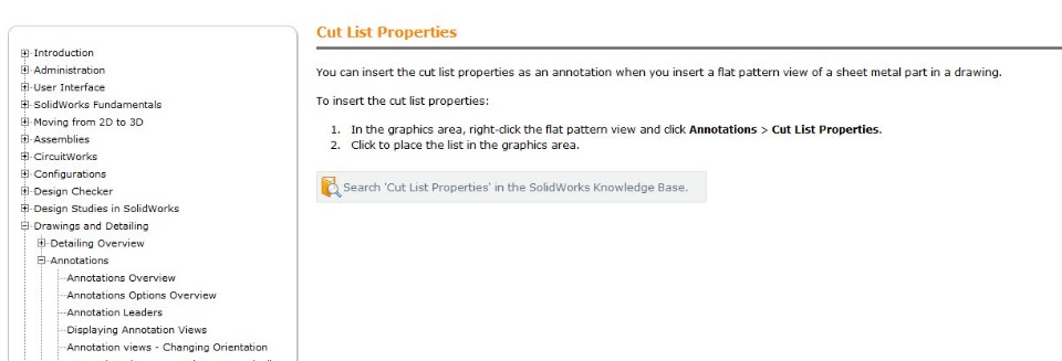

I have been trying to add the Sheetmetal properties into a drawing. In the help files it says the following.
You can insert the cut list properties as an annotation when you insert a  flat pattern view of a sheet metal part in a drawing.
To insert the cut list properties:
  1. In  the graphics area, right-click the flat pattern view and click Annotations > Cut List Properties.
  2. Click  to place the list in the graphics area.
When I go there I don't have this option. Also i would like to have the option to attach these properties as notes to my drawings.
Dose anyone have the anserw to this or are these new features not finished yet.

this is a feature of 2011 correct?
i'm guessing not many users are using 2011 yet.
DG
DG 2010-12-07
Yes this is a new feature in 2011. As it turns out I have just recieved an outcome form my VAR and its not one I am happy with. See below
