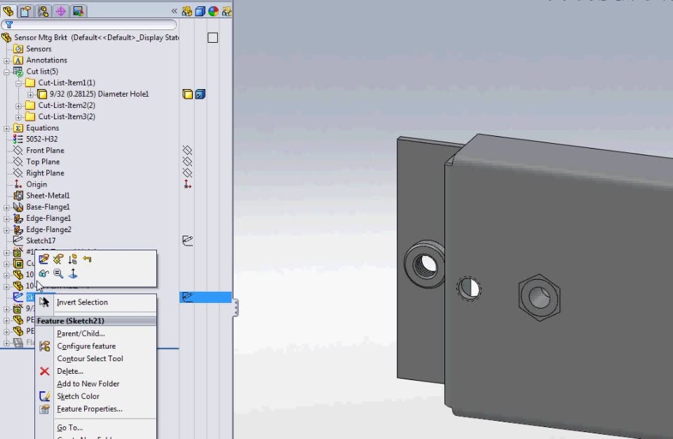

You are correct, but that doesn't solve the problem.  Watch the attached video please.  You will see that I can "show" the solid.  Go to edit a sketch.  Close the sketch command, and -poof- the model runs behind a tree and hides again.

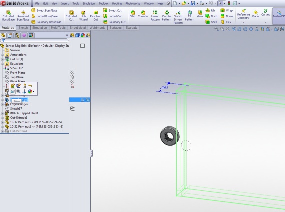

I find that I open the part and all it takes is a rebuild (Ctrl-B) to toggle it visible or not.  I find I can get that to stop by suppressing Edge-Flange2 and the 9/32 HW feature.  This also suppresses the PEM hardware.  But just suppressing the PEM stuff does not stop the issue - it takes the others also.  So it appears that it's related to the Body-Move stuff.
The  only way I found to really stop it was to suppress the 4 Body-Move features and rebuild (do a rebuild after each step.).  Then suppress the edge flange and the HW feature, which also suppresses the PEM stuff.  Then unsuppress the 4 PEM items.  Then unsuppress the 4 Body-Move features.
