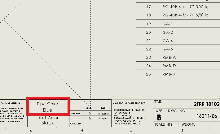

I'm trying to retrieve the highlighted cell from my drawing's TitleBlock as seen in the attached image. However, whenver I attempt to get the TitleBlock it returns null.
Here's the part of my code(C#):
swDraw = (DrawingDoc)swDoc;
Sheet swSheet;
swSheet = (Sheet)swDraw.GetCurrentSheet();
swTitleBlock = (TitleBlock)swSheet.TitleBlock;
swSheet.GetName() returns sheet1 as expected, but swSheet.Titleblock return null.
I have no clue why this is. If anyone has any idea or has an alternative method to retrieving the information I need please let me know.
