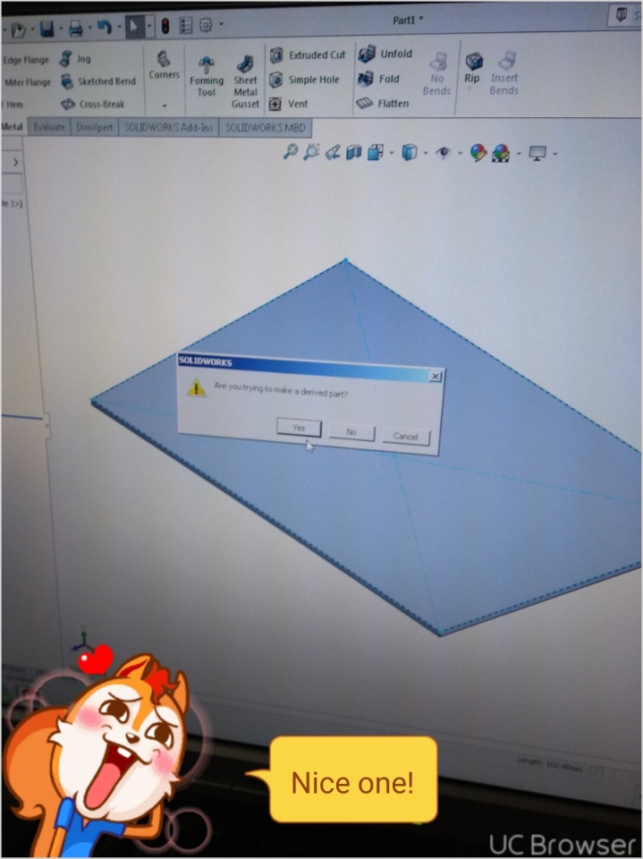

While I was practicing at home ,an another problem arises that when I insert the punch ,the forming was not coming,I have attached an image to it please see to it

Right click on the punch folder in the design library and select "Make forming tool folder". This should fix the issue.

Hi Mohd,
The error that you are getting as you try to insert a punch into your sheet metal part is something that happens pretty commonly.  To fix it you would need to go to your Design Library, right mouse click on the "Forming Tools" folder, then select the "Forming Tools Folder" option.  This option changes the way items in that folder behave so that instead of making "Derived Parts" they are inserted as Forming Tool features.
