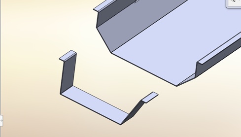

I have 2 sheet metal trays and I need to create a loft/ boundary between them. A loft that can be made with sheetmetal and does not have a twist in it.

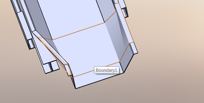

I tried a boundary between them and I got this - that does not even look right it has twists in it.
I basically know what I want it to look like and where the folds will be.
but the boundary feature only lets me select about 3 lines as guide lines. Why can't I select all these lines and make it transition along them.

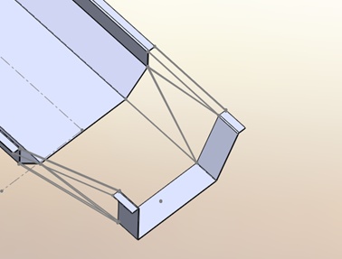

I have also tried this boundary feature with a solid-
1) Why can't I create a solid that takes up the space within a 3d sketch? surely some command can do this - and I could convert this to sheet metal.
