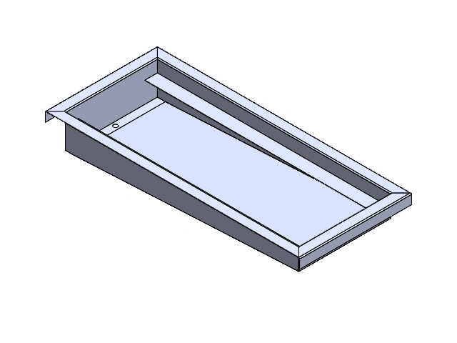

Is there a better way to make this sheet metal part? I'm trying to avoid having the bottom 4 edges welded. The tank was originally created with a flat bottom, then a extrude cut was used to make the 3 degree incline. This splits the part into 5 separate bodies.
I was looking at starting with the inclined bottom from the beginning with custom edge bends to create the flat top, but then I couldn't use the miter flange tool.
Any ideas are appreciated!

Depending on the capability of the press and dies, something like this.  I will let you play with the remainder.

Starting with the bottom and then building up the side with edge flanges + mitre flanges would be a good way to avoid separate bodies but it will still require a bit of creativity

You could build a solid body and convert it to Sheet Metal.

John and Eoghan, thanks for the guidance! It looks like the multiple edge flanges is the way to go

The ultimate factor is going to be the capability of your press brake and operators and will it actually flatten out so that it can be cut out. If you make a part in SolidWorks that can't be made out in the shop, then you've done no good at all.

For what it's worth,,, It is conceivable that you can take what you have (multiple bodies created with a base flange and Miter flange and angle cut) and make it work so you don't have to fiddle with the mitering. Let the miter flange do the work so you get really nice corner miters. Your file is a future version for me so I took some dims from it and modeled my own the way I think you modeled yours without adding the separate plates on the bottom. Just added a couple of edge flanges from one end to the other. One of the edge flanges is merged to the short end. Up to edge and merge.. Then added two more short edge flanges along the angled edges so I would have a bend to merge to the long sides. Combine the three bodies to make one.
