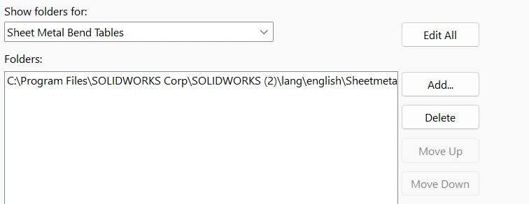

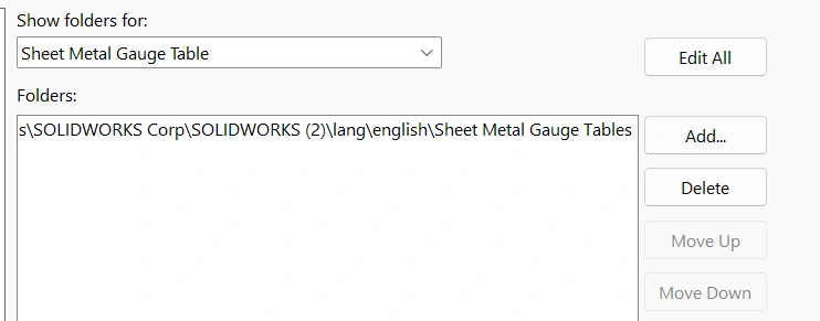

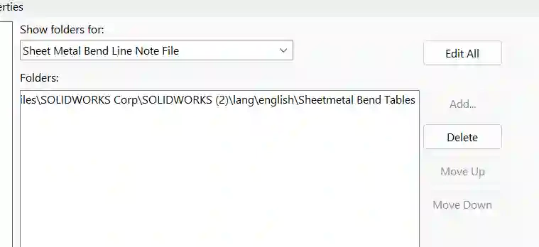

I'm trying to create a basic shape—an oval—and then flatten it using sheet metal. I've tried several tutorials, but nothing seems to work. I'm not sure why. I’ve made sure the material is applied correctly and that the file paths are accurate. I also tried using a circle instead of an oval, but it didn’t work either.

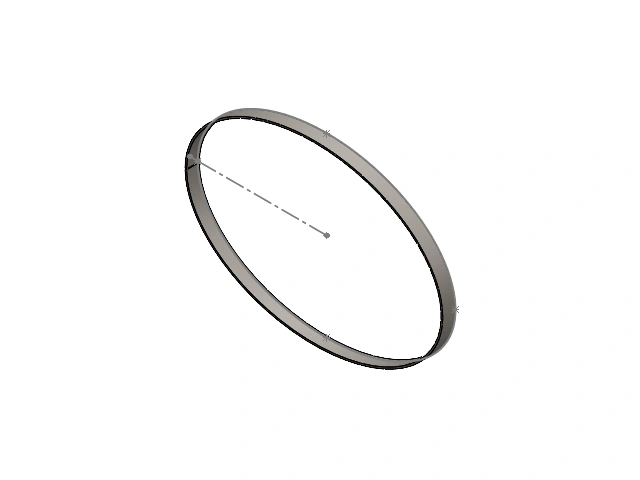

what version are you on it came perfectly flattened in the file you shared
comment imagecomment image
