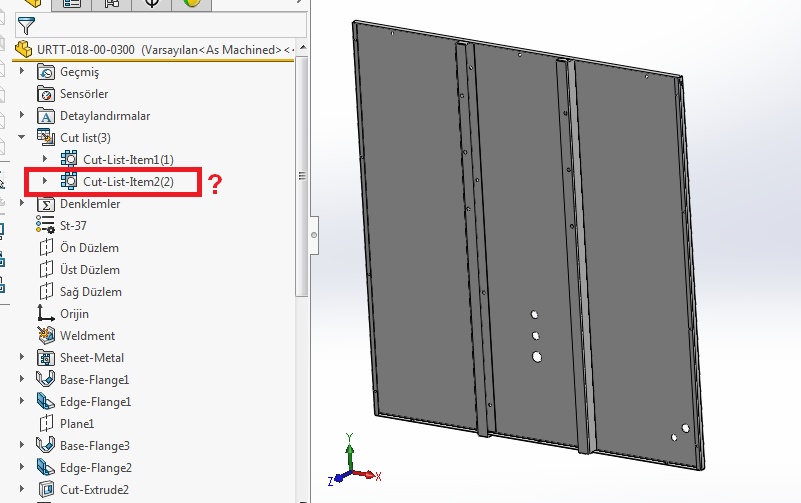

Hi,

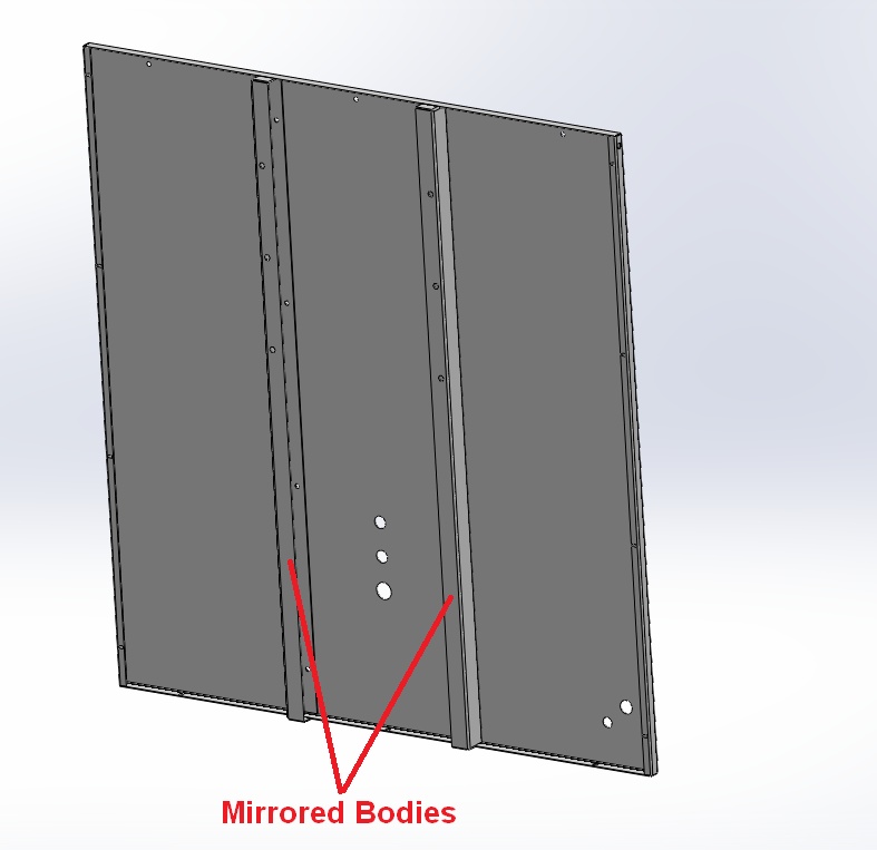

I'm working sheet metal with multibody as below picture,
Cause of body mirror theese parts' flat patterns are same, but cause of hole position bending directions are diffirent, that is i'm trying to explain 2 parts are different. But Solidworks 2017 SP0 is showing as same parts at cut list.
I'm sure that solidworks 2008 to 2016 was providing us to perceiving whether parts are symetric or not
Shortly, if i draw this parts with Solidworks 2016 there wont be any problem. I was be seeing different 3 item at cut list
is it software wrong or is there any option to correct it?
Thank you for your urgent answer....

SW2017 did change the way items in the cut-list to be combined but I thought that was an option.  Is it possible for you to upload your part to take a look at?

As I previously stated, SW2017 added functionality to the way it combines bodies.  Similar to Dennis' part, when I mirror the body, three cut list items are created.  However, if I right click on the cut list folder and select "Cut List Sorting Options" and in the property manager check "Collect Identical Bodies", exclude the cut feature used to create the holes then green check, now I only have two cut list items.  My recommendation is to check your Sorting Options to see if someone excluded the holes that make the pieces opposite hand.

I check shoting option but nothing checked. Although "collect identical bodies" not checked and although nothing exclude i seeing 3 items

I am on SP4.1 and if all I do is press Ctrl+q, the cut list separates into 3 list items.  So maybe there was an issue with SP0

I also found if I suppress and un-suppress feature Cut-Extrude1, three items will appear in the cut list
SA
SA 2017-12-01
If it is indeed a service pack issue and you cannot upgrade to the latest SP then you will need to create the cut list manually (like in the old days).
