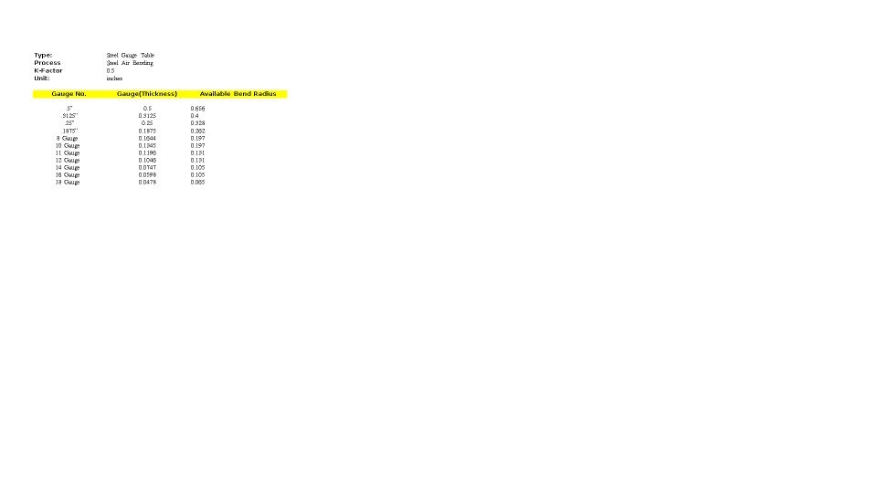

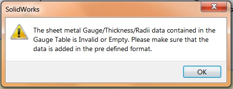

I entered some custom data in a sheet metal gauge table, and tried to select it to use in a sheet metal part. It gives the following error.
Is my problem that the table cannot accept the format of .25", .1875" thick steel? If so, how do I make my table work with these values?

Joseph,
Try removing the space on row 8 (above .5)
Frank
JS
JS 2014-01-29
That fixed it. Thanks, Frank.
