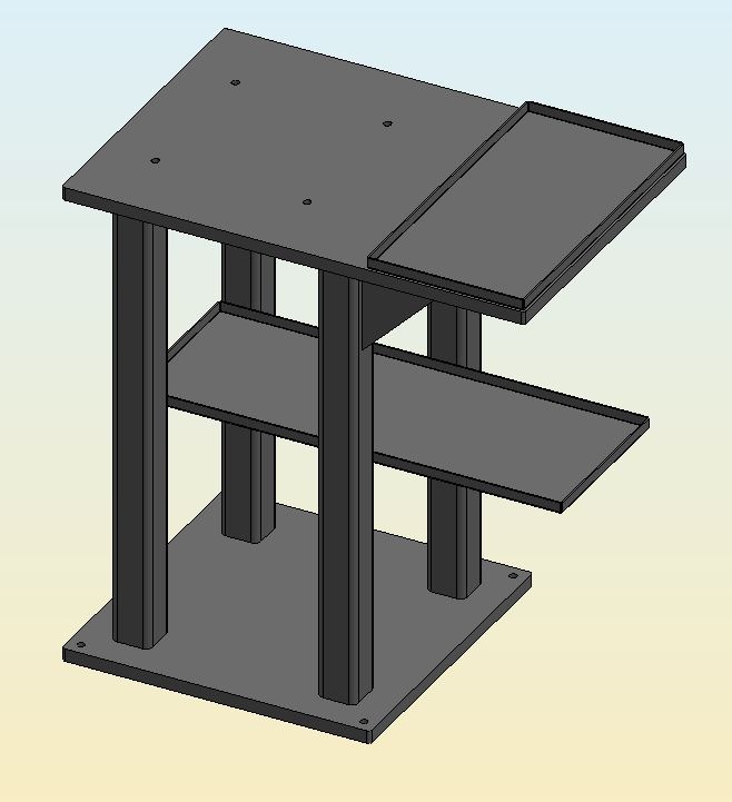

Image below is what I am detailing. One weldment with two sheetmetal pans, combine to make one weldment. It is one part file.
Is there a way to get the two flat patterns in the drawing, then label them as a prefabricated item?

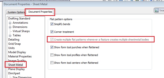

Insert a new view into your drawing. Use the "Select Bodies" button to select the first sheet metal body. In the orientaion window, select "(A) Flat pattern" in the More Views window. Repeat for the second body.
This will automatically create new derived configurations in your part file showing only the flat patterns for each body.
Yes but make sure part is a multibody part and you've this option as in the picture selected. Finally go as Patrick suggested.
