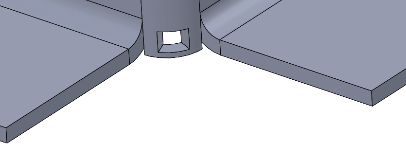

When adding edge flanges to 2 sides of a bent face to act as mounting feet, SolidWorks 2023 isn't adding a relief.
I'm setting the edge flange position to be "material inside" so that the overall height of my part doesn't change from my original layout sketch.
If I use the "bend outside" option, the part looks fine, but I want to avoid having bend offset dimensions in my original layout sketch to account for the extra part height from bending outside.
Ideally I'd like solidworks to have either a cut straight across at the start of the bend (blue line) so the material doesn't tear. Or even a radius relief like the red line. I've tried using "Corner Relief" feature but it doesn't recognise these points as corners. Or when it does recognise it as a 3 bend corner, only the rectangular relief will work which results in this.

Jaden,,, It looks like you don't have "Trim side bends" selected.
