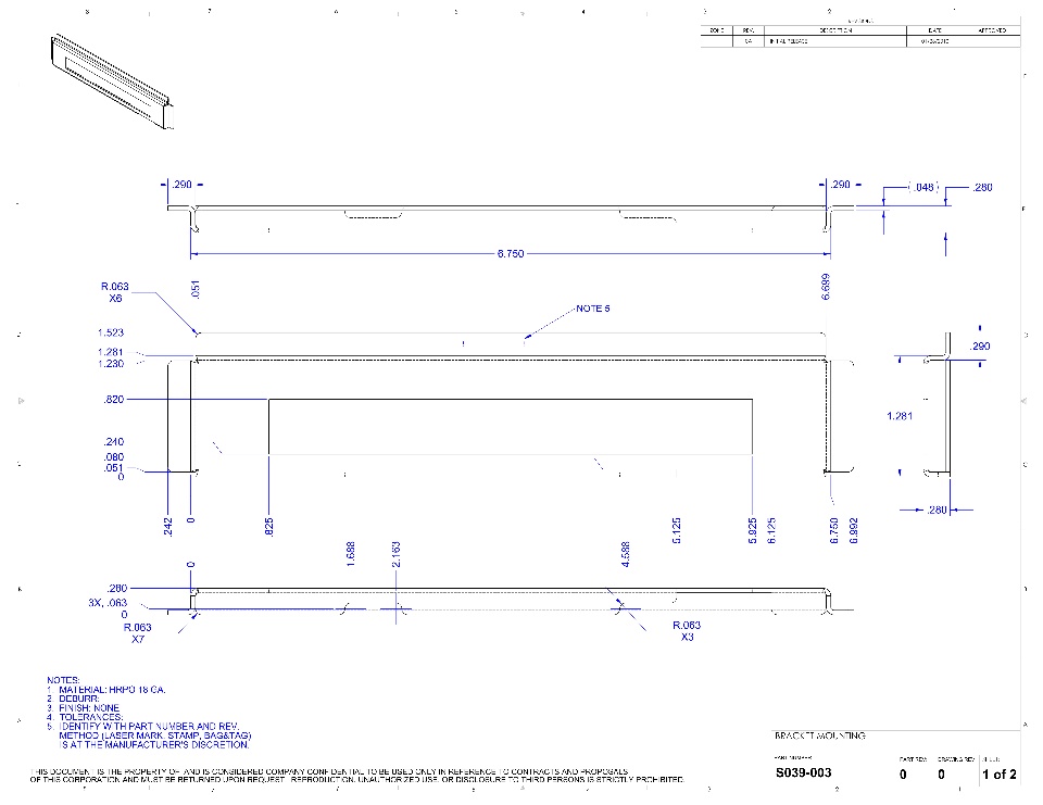

hello,
i was wondering what kind of standard views you guys put on your sheet metal part drawings. i have attached two sheet metal drawings with our 'standard' views. what i have done is added a top view off to the side of my template, then i added section views to get the 'formed' views to show up like they do. the reason we do not use a normal side or top view is because if we have a return flange it could be covered by another flange. i was just wondering what everybody ells does.

I love this topic.  I think drawing standards are so important that everybody should have one.  We probably won't ever settle on the same standard, though.
I've attached a PDF of your original and my version of the same drawing so others who haven't jumped into SW2010 might join in.
Your method does a nice job of making it easier to spot where the corner radii are.  In my drawing, they are there, but the resolution of the hardcopy needs to be fine enough not to blur them out.
My hot buttons:
1) Isometric views must show tangent edges but not hidden lines.
2) Projected views must show hidden lines but not tangent edges (that keeps the press brake operators happy).
3) Add as many projected views and section views as needed, but maintain proper 3rd angle projection (yes this is USA centric, but that's where my parts get manufactured).
4) Flat layouts appear on their own sheet (they are mostly for use by the estimators with only a passing glance by other processes in the shop).
5) All parts must be marked showing the part number & rev and the drawing has to show where.
6) A revision should appear for both the drawing and the part (yes this is a pain in PDM but it is worth the pain)
7) Dimension the part so it is easy to inspect with calipers at the press brake (using edge-to-bend or bend-to-bend dimensions; dimension the other details with ordinate dimensions for QA to check with a CMM during setup (specifically for Turrets or Lasers).
8) Always dimension the material thickness (yes, this is redundant with the notes but helps goof proof the model/drawing revisions.
Probably the most important point is to make drawings that please your manufacturing shop.  I use several subcontractors and this drawing scheme satisfies most (but not all).
As a former press brake operator, I think I'd prefer my drafting style.  Section views require an extra neuron to process and I don't have any to spare when working on a time clock.

Yeah we pretty much do the same thing, standard full scale 3 view with an NTS iso view up in the corner of the dwg sheet.  Our dept made it a mandate that sheet metal with more than 1 bend requires a flat pattern.  We dimension to the bend tangents since the shop uses a hand break.  The shop seems pretty happy with that.

i have really wanted to go to a two page system with the flat pattern on page 2 since our laser & turret punch people are the only ones who pay any attention to it, but we still keep hard copies of all of our drawings here and that would be too much paper to store and keep track of. i really do like that concept though.
The problem we had was one of our section views (in the top view thats off the page) was in the an area where the return flange was notched out so the return flange wasnt in the section view and never got dimensioned. that drawing made it past the person that checked it (me!) and was released for production. one of our press break guys came to me and said "i think your missing a flange, why did SolidWorks miss a flange?"

the flange was there i just had the section cut line on the wrong area where the return flange wasnt located. so on my section view the flange was missing
