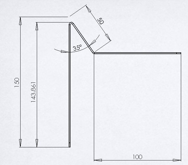

Is there a setting within solidworks that allows my sketch dimension to be the finished size of a folded piece of sheet metal. In the attached you will hopefully see what I mean. Its something thats been bugging me for a while now.
You will see that the dimension of my sketch is 150 but the actual dimension of the face of the sheet metal component is 143.861. To the guys that fold these components the 150 dim is of no use as it is to fresh air as far as they are concerned.
What I've been doing is subtracting the 143.861 dim from the 150 dim and then adding the difference onto the 150 dim just to make the actual face the size I want it to be.
Surely there is a better way.
Thanks
Steve

Hi Steve, I understand exactly what you mean. From what you're saying, to me sounds like you must of made the part using a flat base part and added edge flanges. Is that the case? If so then on a part similar to the one you have shown you may try a sketch profile and thin extrude. Then you could us the dimension in the sketch and bring them in, in "show annotations". Thanks, Daniel

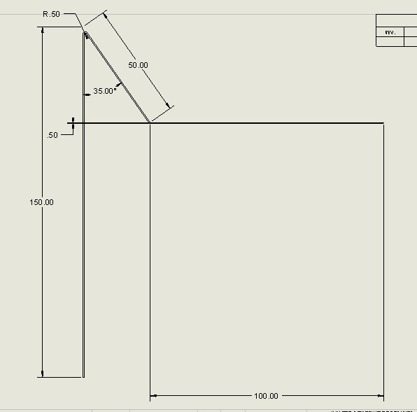

I've attached my model to show how I constructed the geometry. I started off with a profile sketch and then went from there.
In the attached however I've already made my modifications to the sketch to get the dims I wanted to end up with.
Thanks for looking
Steve

Super Steve now all you have to do is in the drawing pick inside the view and insert model items and pick dimension and you're set. Thanks, Daniel

Please check attached file, which I modified and see if this solution works for you.
It's all about the approach you take at the part. In this situation, the way you built the part, from one 2d sketch into a base-flange, this tweak I made seems to be the best way. All i did, was create some "smart" construction geometry in the baseflange sketch (sketch1)  that gets that outside edge you're wanting to dimension to. If you don't understand how the equations work, ask away, I'll be glad to help.
Hope this helps...
Cheers

Yes your solution seems to work just fine and thank you for taking time to come up with a solution.
