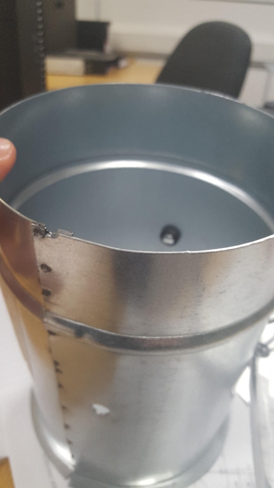

Hi Guys,
How to draw this part? Sheet metal cylinder with overlap for welding. There is also shroud on bottom end and swage roll in the middle. How to?

I had nothing, because I was trying to play with features and nothing came up.
But finally I have managed to get something like that.
Still need to make that swage roll and shroud on the other end... im now trying to play around with swept flange

Sure I got that. But still dont know how to make swage roll in the middle and shroud flange at the end.

Ok I got the model and nice way of doing this from this thread:
However it will still not be the same as per picture to have it bend without extra flanges and overlap on whole length including swage roll.
Any ideas?

- What I would do is use the Swept Flange to produce the flat pattern and if you need to add the swage profile for a pictorial view then I would just model that.  That swage shouldn't affect your flat pattern development..

I think I'm going mad because I can't do things you advise me to do What I want to achieve is a overlap for welding + swage roll. Model has to be flatten. Exact copy of real product.
