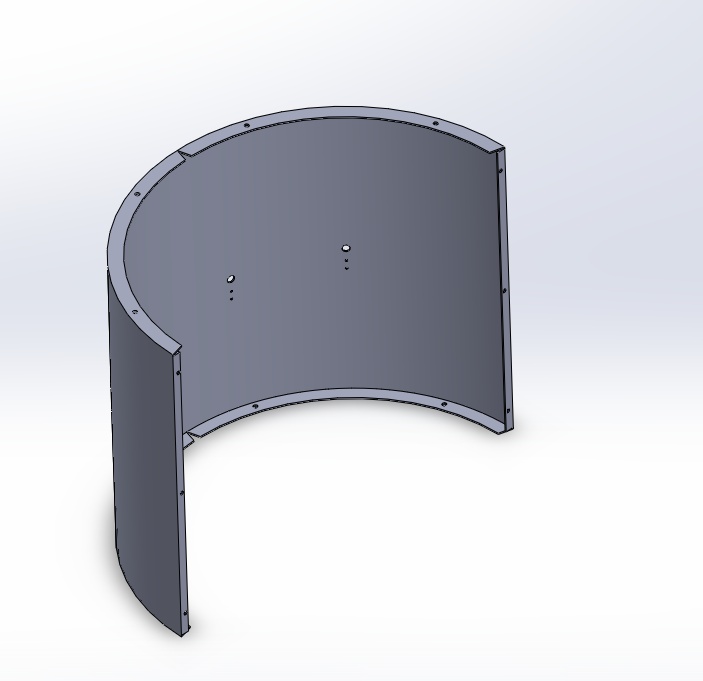

G'day Fellas,
I am creating 2 halves of a cylinder and I want tabs on the top and bottom so I can mount them around my machine. I can make a base flange and then do an edge flange from that but I can't get the inward flange on the opposite end.
Attached picture is an example (created using non-sheetmetal features) of what I want to create.
Thanks Heaps!

What release are you using?  Did you try the Sheet Metal Sweep feature, where you could draw the vertical, top and bottom flange profiles and sweep it, then add the edge flange feature for the small bend at the ends.

The inside radii of the part would buckle the way you have it modeled..  You might be able to roll it if you had quite a few segments to your flanges.
You could probably do it with bump bending and a segmented flange.  It wouldn't be round, but it would be possible to manufacture.

Technically what you have is a Drawn Shell. SolidWorks Sheetmetal does not do draws. I'm not really sure why they don't do draws since Logopress3 does draws. (I have postulated in the past that, since Logopress3 is a Gold Partner, Dassault is protecting them)

I personally have never been successful (don't think/can't remember) in rolling sheet metal with flanges as long as yours looks inward, but like John, I'm pretty sure it can be done. It will be interesting to see what Bernie has to say about this. I have attached a file done with the swept flange as John suggested (2017). Your part can be modeled in SW sheet metal and flattened. Whether it can be manufactured (in one piece) is another issue.

Just make a series of triangular cutouts, in the flat blank, along the top & bottom flanges (just like your center cut triangle). But you already knew this...

Dimensions are as follows;
Outside radius - 280mm (11")
Inside radius - 260mm (10.24")
Length of flanges? - not real sure, at the moment each of the 2 flanges on the top is 408mm long (16")
Thickness - about 2mm but im not too fussed - could go down to 1mm?
Bend radii - im flexible on that too, although keen on 2-5mm

I just had a look at the part and these are my thoughts. The large radius seems large enough to form by hand around a mandrel of sorts after rolling the end segments as well as the 90 degree end flanges left and right, top and bottom. That is leave about 60 degrees of the middle of the part unformed, then use the mandrel and hand form.
Unfortunately the triangular cuts would likely cause a kink during forming, are they required?
Rolling would be eased by making the top and bottom flanges as short as possible as I suggested earlier. I some cases I have used 'filler' materials to allow the rolling on a three point roll. Depending on the length of the flanges you might need more than one piece each rolled to be filler to arrive at a good height. I have sandwiched material to allow for this, there are no flat spots or kinks as a result.

I spoke to my workshop and we agreed on the following solution: Make the middle from sheet metal including the sides that are bent in.
Then weld the top and bottom on.
I couldn't have made the middle as sheet metal if it weren't for the explanation of using the swept flange feature
