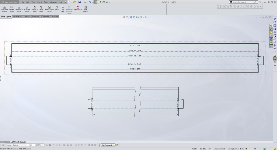

Here is an idea Ilkka..  Prior to breaking your view Ctrl select your bend notes then in "Leader" select the straight leader (without the x) then drag the arrowheads over to the ends of their corresponding lines. Then Ctrl select again and in Leader select the straight leader with the x to remove the leaders. Seems to work.

Of course now that we know where the note leaders are attached (middle of break lines) and we know we can't break around the arrow heads we could double break the part and leave the center intact. I might look cleaner this way and you don't have to drag the arrow heads to near the end of the break lines.
