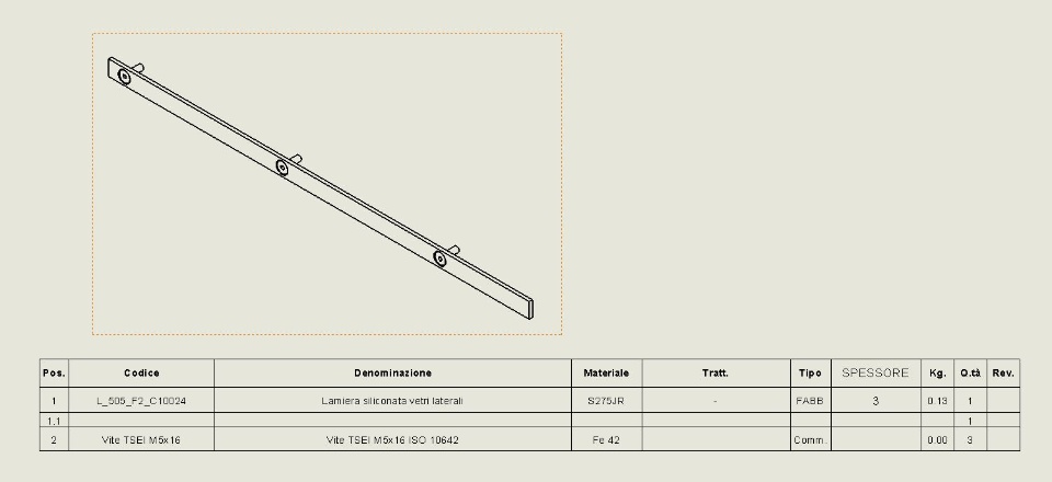

I have to create an indented BOM for some sheet metal welded assemblies.The issue is that when i crete the BOM with detailed numbering,in the table i have a line for each sheet metal part that has no properties compiled.The blank line refer to same part .I attached a picture with a small assembly.
So i want to know why this line appear and how to remove it.Remove it manually is not an options since i have assemblies with more than 500 comp.

What are options you have set for the BOM?
Can you attach this assembly to check?

Doru, I'm not sure if this is an indented behavior but you can use a workaround.
Open the sheet metal part. Expand cut list, right click on cut list item and select "Exclude from cut list"

Hi,
Thank you again for the quick answer.I don't have the exclude option.Anyway, it is a pain to open all the sheet metal parts and exclude the cut list.The way it worked for me was to delete the cut list,but again i have to open each sheet metal part.Maybe it is because i have Sw 2010 Sp0.I will have to pay attention in the future when i crete new parts or maybe i will not have this problems with sw 2011.

Make sure you don't update the cut list by mistake else the issue will pop up again. On another note, I would suggest you to report it to your VAR.
