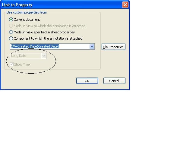

I am having the problem in changing the drawn format. It displays in long format with time. But I need is only short format and this option is disable in link to property dialog box. See attached pic .

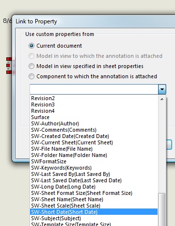

Strange, if I select SW-Created Date(Created Date), the drop down list is enabled and so is the Show Time check box. Do you have the SW-Short Date(Short Date) as a choice? see attached.

Yes I have one, but I don't know "show time " check box is disabled.

its not the date format issue. Problem is disabled part in attached image.

I understand now. My "Show Time" gets enabled when I select one of the options from the dropdown list. Sorry I couldn't be of more help. Good luck to you.

The 'Show Time' box is only enabled if you select the SW-Created Date or SW-Last Saved Date options.  It is not enabled when SW-Long Date or SW-Short Date are selected.  Seems really odd.  I'd like to use the time in our default formats, but I've never been able to figure out how to do it.
DT
DT 2009-08-06
Mark is correct...I knew it was one of the options but couldn't remember which one. Thanks for clarifying.
