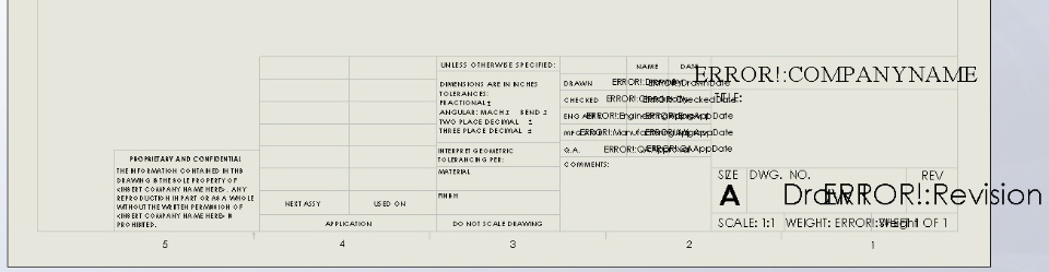

Sheet Format Issues
Does anyone know why my templates (default or newly created by 3rd Party engineer) open with the errors shown in the attached image.
Answers 17
TP
TP 2012-01-25 Best Answer
Looks like your custom properties are not set. If you look at your custom properties list is there any custom properties there like "Revision"?
DC
DC 2012-01-25
Could you elaborate please.
JM
JM 2012-01-25
Don, we would want to see the Sheet format page showing the same view.  (right click - edit sheet format)
It's very important that the custom property is coming from where you want it to.   If you want it all to drive from the model, or just exist in the drawing.
I believe that the error is how they connected to the custom property and tried to type it in, instead of connecting via the "link to property" function in a note.

DC
DC 2012-01-25
Thanks for elaborating.
I checked the SW default templates and they have no properties at all. No big deal as I won't use them, but one would think that the program templates would have been created properly.
The 3rd Party Templates have a number of properties assigned, but some look like they are missing. I will see about adding them correctcly. Does anyone know what those Value / Text Expression letters mean and where to find a list that shows possibilities in that regard?

DC 2012-02-11
I thought that I would post an update about all the issues I was having.
Even with all the great help I received from some of you gents I continued to have the same template errors popping up. I finally contacted tech support at my client's reseller. The gal I corresponded with could open our templates and experienced no trouble at all. So, she had me delete the SolidWorks registry data and then restart SolidWorks. SolidWorks rebuilt the settings and all the error were gone when I opened the templates. I don't think I would have thought to try that. We now have out new templates operational and they work great.

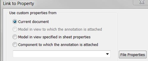

TH
TH 2012-02-24
Hello,
Best way to get rid of this annotation link erros is just turn them off. Look at pic:
If you use someday those props, they become visible...
- Tapsa
