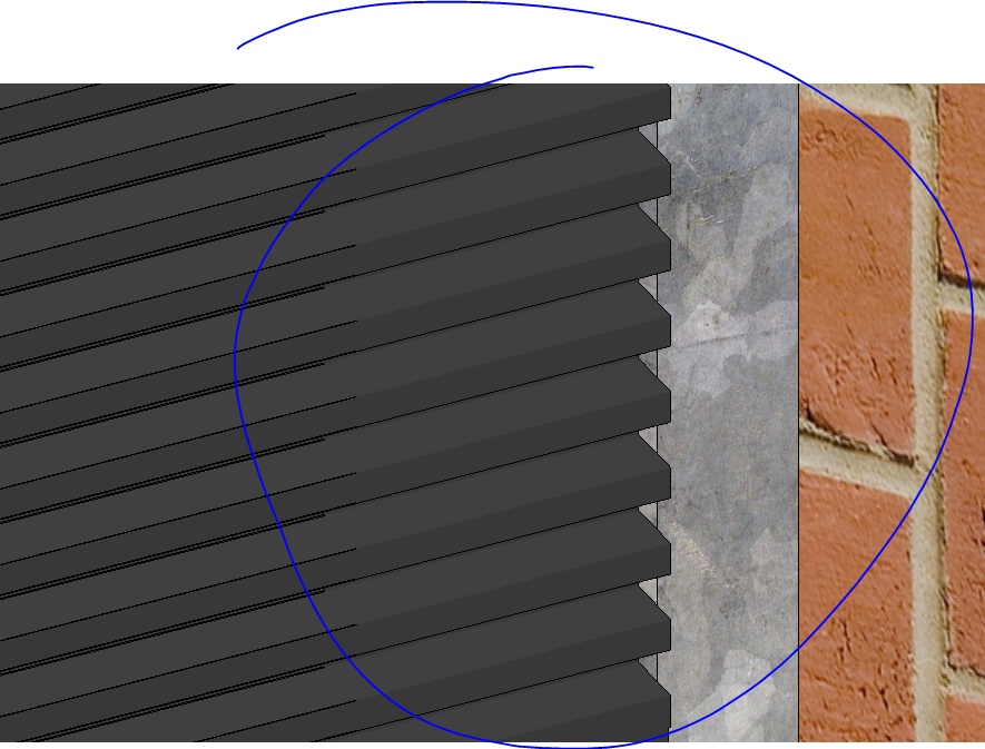

Hello,
Could anyone explain this phenomenon to me?
Shaded with edges in selected in a isometric view. High Quality lines.
Still some edges seem to be missing.
Thank you for the help.
Greetings, Robbie
Hello,
Greetings, Robbie
Hi,
it seems to be the setting for tangent lines. Use the context menu in this view, and see the settings for tangent lines. De-activate hide ends (or how ever it is called - in German it's "Enden ausblenden").
