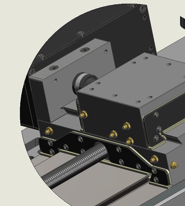

I just started working with Solidworks 2012 and one thing I am noticing but annoyed by is the edges in a shaded drawing view. When I show a shaded view the edges are dashed lines. Is there a way to make them normal. They print out like they are suppose to but working with the view and dimensioning they are annoying. See attached picture of what I am talking about. If I zoom out the lines get larger and I can barely see some of the features. Any idea?

Does this show like this in all your parts and assemblies?
Lets try a couple of things one at a time....
1.  Go to VIEW>SKETCHS and make sure this is turned off
2.  RMB on annotations and uncheck all options
3.  Close all documents in SolidWorks then go to TOOLS>OPTIONS>PERFORMANCE and check the box for "use software open gl", now open a solidworks file you know showed the hidden lines; are they still there?
See if any if these clear things up....

SF 2012-05-08
Thanks, it was the "Use software open gl." Not sure what that means but itsolved my problem. Thanks again.

That's only a bandaid - the problem is either your video card or driver.  The fact that you are using a GeForce likely means you should just leave that box checked and go on.

the use software open gl setting bypasses your video card. so if that solves the problem, you will want to check your driver and card, first to see if they are "approved" and then to see if you want to upgrade.

Yea those computer specs under my icon is my home pc. My work pc is the one I am having problems on and is only 1 month old. My work PC is currently running a Dell Precision T3500 Intel Xeon 2.5 GHz processor 12gigs ram, NVIDI Quadro 600 Graphics card.

If checking the "use software open gl" corrected the issue then it is your video card / driver that is the issue.  Either the card is not supported  or the driver is out dated.  You can go to the SW website and check your card / driver versus your SW version
http://www.solidworks.com/sw/support/videocardtesting.html
If you see your card / SW version on the page after filling in the drip downs you can click on the drive build and it will automatically download the driver from the SW webpage.  If you do not see your card you may need to upgrade.  If it is an older pc or you are not in a position to replace the card it is perfectly fine to run SW with the "use software open gl" checked, you will just notice some chunky graphics when doing rotations, etc.

Yep looks like it is out of date. Ill update to the new update.
