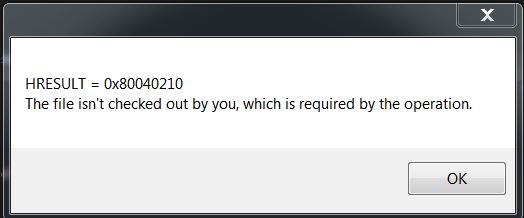

SetVar returns "File is not checked out by you" when it is
I am writing an add-in to prompt users to fill out a revision description when an approved drawing has been revised. I used to have Dispatch do this, but there were too many glitches with Dispatch to make it useful. I am able to use GetVar just fine, but when I use SetVar I get "The file isn't checked out by you, which is required by the operation". But when the program terminates, the file IS checked out by me on my workstation (which is done with the .lockfile command prior to setting the variable).
I am using VB.net with Solidworks and epdm 2016 SP4
