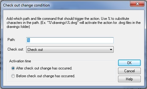

Therefore, I want to change the dispatch action into changing the variable at the check out instead of check in (I know that drawings will show the future version number until the part file is checked in, but that's ok).

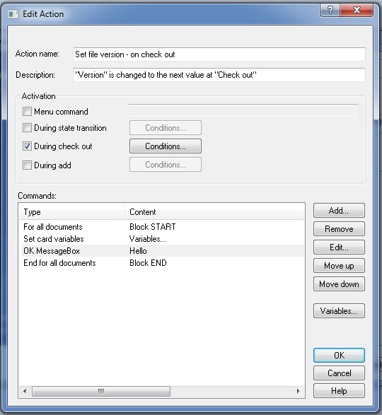

I changed these options, but the variable is not updated, I can not find out why. These are the settings:
The message box "Hello" appears as it should during check out. But the variable is not changed.

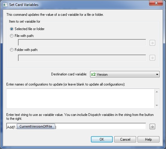

EDIT: I have also tried to use a simple equation:
Add(2,3)
It is not working at check out. I have no idea why ...

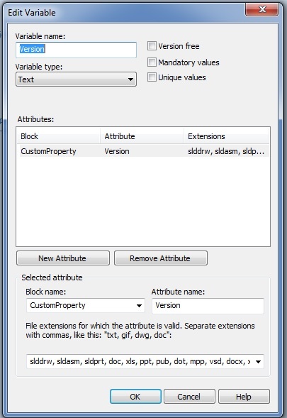

These are options for a variable:
Everything is working correctly according to the manual - if the variable is changed during check in, so the settings of the variable are fine. But in my case I want the variable to be changed at check out, and it is not working. The message box is shown, which shows that the trigger is working, but not the change of the variable. Would you please help me clarify what am I doing wrong?

I tested with 2015 SP4, your settings worked for me. There were some weird set card variable issues with Dispatch in 2014. (Still some in 2015 too ) What are you running?

After your post, I had a suspicion that a variable called "Version" might cause some glitches as it is exactly the same as the system variable for actual version of the file. Therefore, I created a new variable called "VersionT" (for temporary value). I have tested it further, and I have noticed, that actually the value is assigned to this variable as it should be, and it is displayed in the data card. However, this variable is not written to the custom property of the file.
Interesting part is, that it sometimes is working: I tried to increment the value of 10 (current version of file plus ten) - it started working ! Both data card and the custom property. Changed it back to "plus one" - what do you know - it is not writing custom property anymore. Changed it back to ten - still nothing ... I really don't get it - tried restarting the workstation - doesn't help. Looks like a bug ...
So, probably dispatch has nothing to do with it. This is the variable itself:
Is there anything else I can do to make this variable be written to custom properties?

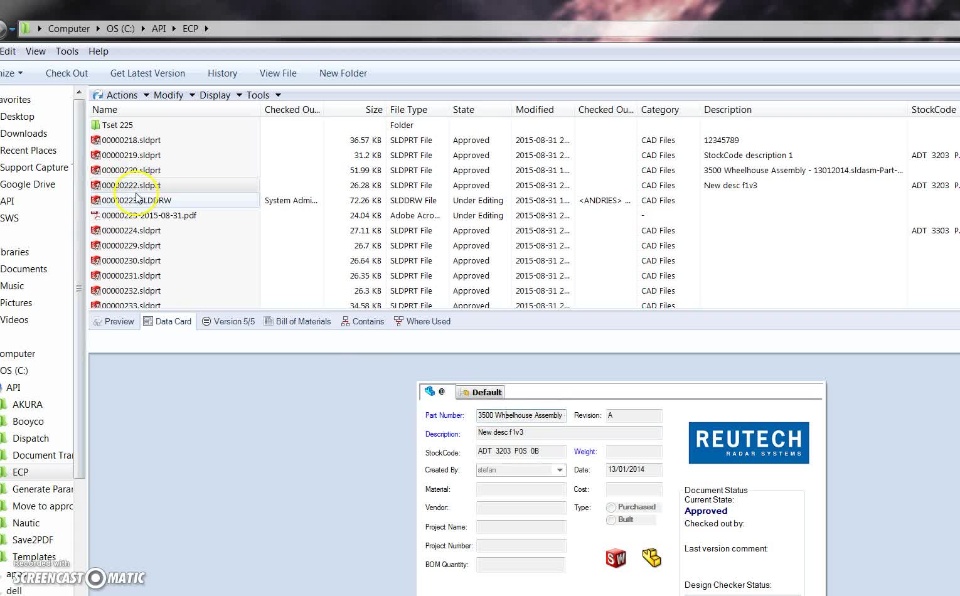

I set this up for a customer but got there slightly different.  Instead of doing the add operation at the “Set Variable” command line I do it in the dispatch variables. I’m set for doing this before checkout so it might work a little different but…
I did have to add the Model_Version variable to the data card.
Note: this is on EPDM 2014 SP5.0
Cheers,
comment imagecomment imagecomment imagecomment imagecomment imagecomment image

There is no way to write variable during check out. But it is done at state change automatically. So I created a transition called "Check out and copy variables". Then I used a state "Temporary", with an automatic transition to next state. This way file moves to another state instantly, and also receives all the EPDM variables, and gets checked out.
I also used a dispatch activation "During state transition" instead of "During Check out". And so:
Target: state "Temporary"
Activation time: After change state has occured
And then:
For all documents - BLOCK START
Check out file %PathToSelectedFile% - beware that it has to be a path. IT DOES NOT WORK WITH ONLY NAME
Set card variables - any variables that are needed
End for all documents - BLOCK END
