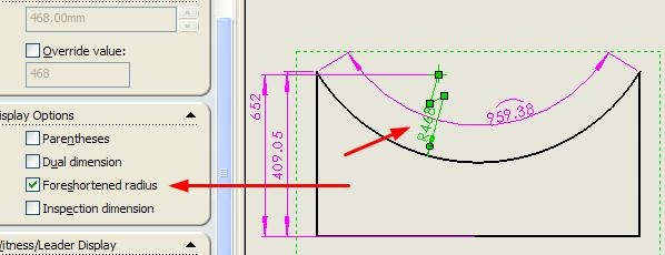

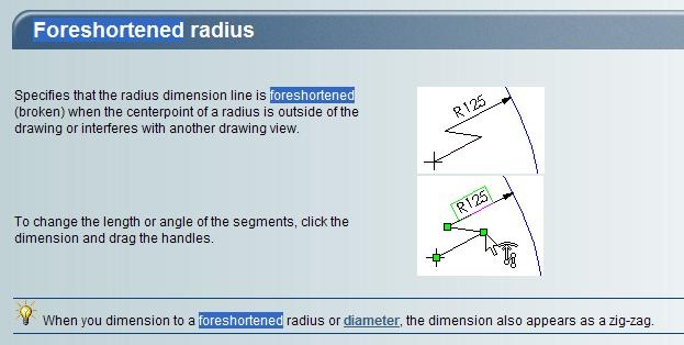

Set the foreshortened Radius with API
How to foreshortened (broken)  dimension. and  move centerpoint of a radius
How to set the Radial Dimension Text Position? | SOLIDWORKS Forums
https://forum.solidworks.com/message/429020#429020
