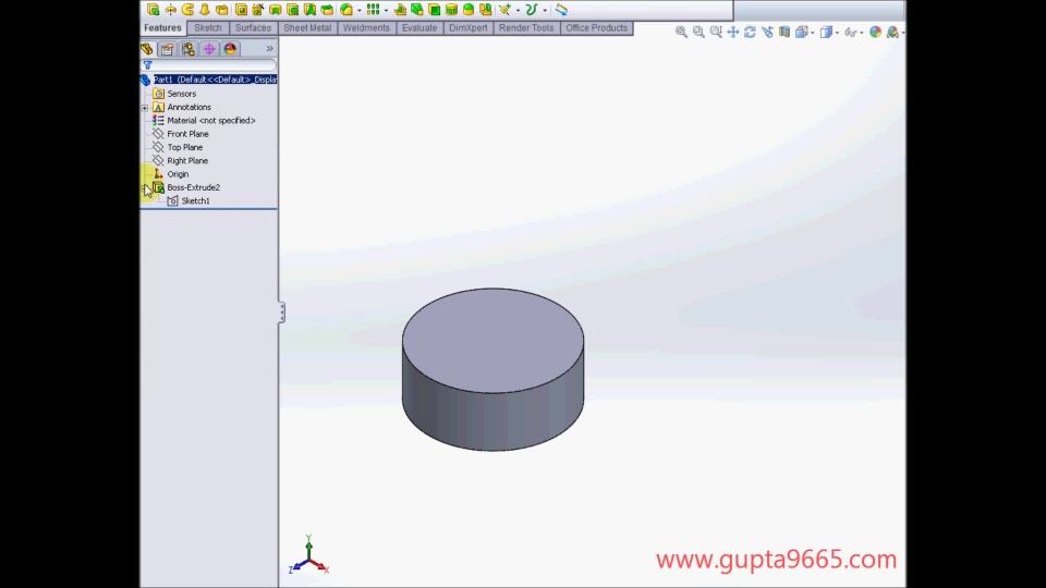

As Glenn and Jeff suggested, you can use the selected contours option to select the area/entities for the features from a multi contour sketch.
Attached a simple video to show that

You can use one sketch for more than one feature.  After using it the first time it will be absorbed by the feature in the tree, but you can expand the feature, select the sketch, then select the next feature while the sketch is still highlighted.

If you check the video I've posted above you can see the steps of using the same sketch in multi features.
