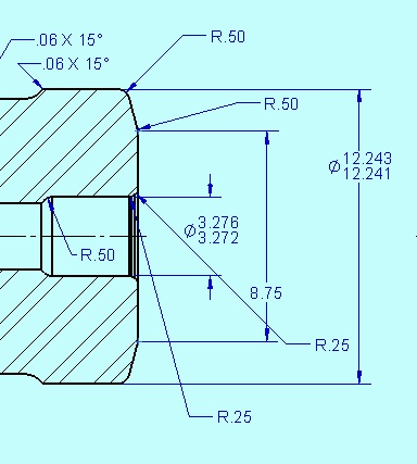

OK, Everyone likes when something is done for them, right? How about these self adjusting dimensions? They go everywhere where you don't want them.  They are placed, put where you want them, you move on to more dimensioning, and then all of a sudden, the placed dimensions self adjust to where you don't want them. See both of the R .25 dims on the attachment. I had them placed within the dimension lines of the 3.276/3.272 dia; totally de-selected, and they moved way out of placement when I added a diameter symbol to the 12.243/12.241 dimension. What the heck is going on here? I like my prints to be proffessional looking, not scrambled spaghetti!

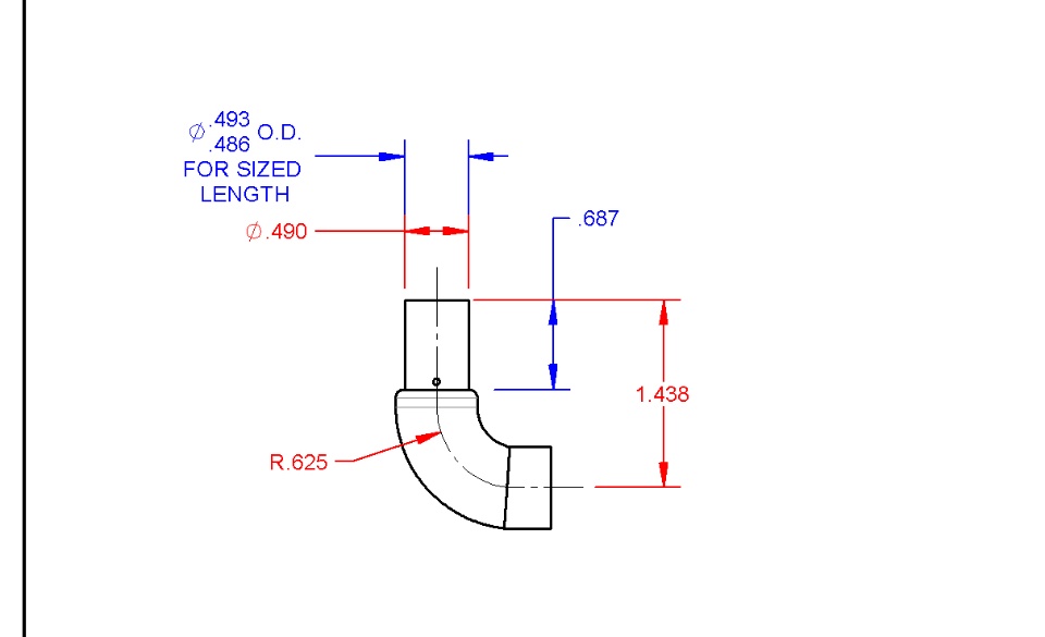

This is particularly an issue when inserting model dimensions ino a drawing view. See attachments.
Red dimensions are created in the drawing. Blue are inserted from a model feature.
The "after" image shows what happens when any other model dimensions are inserted into the view. (Model placement is not switched on).
JH
JH 2011-03-22
Just got word from my VAR on this. There is an SPR on it. A work around is to select to  use dimension placement in sketch when inserting model dimensions. Sounds like it's wired backward.
