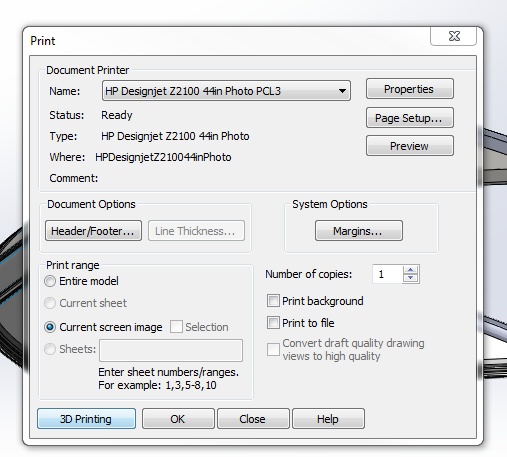

When trying to print full scale in SolidWorks 2012, the selection box in the print menu seems to be disabled. How do you correct this?

Jeremy,
Welcome to the forum. Looking at your screenshot it appears that you're trying to print a model. "Entire Model" or "Current screen image" are the only options that are available for 2d printing of a model. If you want to print your model to scale you will need to create a SW drawing of your model and print that.
Thanks.
