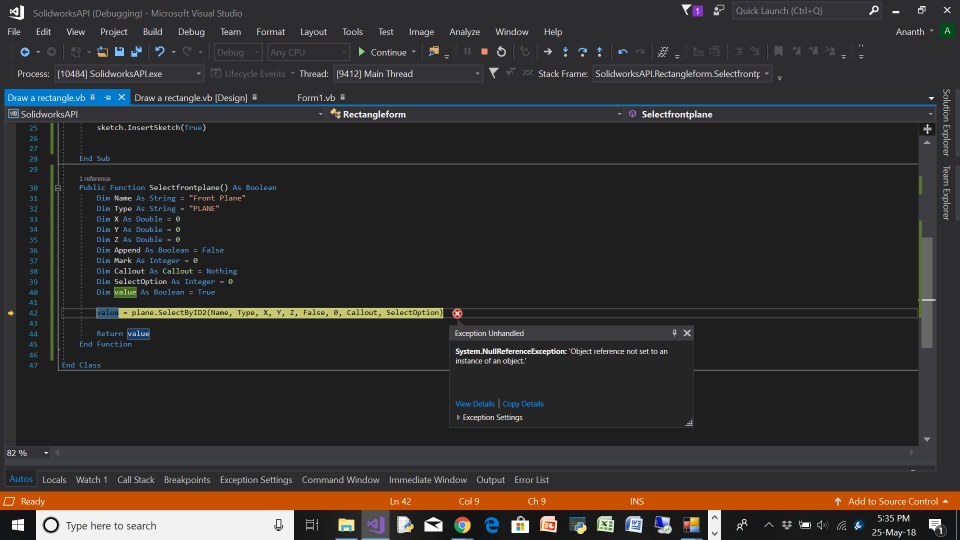

Guys I've been trying to select the "front plane" and draw a  sketch on it. When I execute the file,  the code gives me an error saying " object not set to reference".But its already declared as a boolean. Why is it still showing it as " not set to a reference"

    Public Function Selectfrontplane() As Boolean
        Dim Name As String = "Front Plane"
        Dim Type As String = "PLANE"
        Dim X As Double = 0
        Dim Y As Double = 0
        Dim Z As Double = 0
        Dim Append As Boolean = False
        Dim Mark As Integer = 0
        Dim Callout As Callout = Nothing
        Dim SelectOption As Integer = 0
        Dim value As Boolean = True
        value = plane.SelectByID2(Name, Type, X, Y, Z, False, 0, Callout, SelectOption)
        Return value
