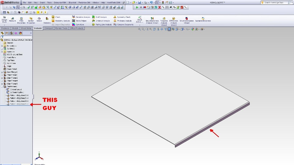

Good Wednesday to you all!
So I've got a macro that makes a flat pattern by stepping through the feature tree and unsupressing everything. I just found a crucial flaw, though. It only unsuppresses features. Meaning that if in the flat pattern feature, if a bend is suppressed, it won't catch it. I was wondering if anyone had any idea how I can access the sub-features?
I've included my code, I realize its a little convoluted and redundant, but it seems to work really well excluding this problem.
Thanks in advance for anything you can give me,
Trevor
