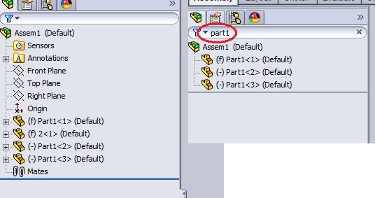

Is there any like command in SWX for selecting all indentical instances of the same part in SWX? In Inventor you can just RMB and use "select all occurrances" to highlight them all in the browser and graphics window.

Type the part number you need all occurrence for on the top of feature tree and SW will show you all of them, hiding the others.

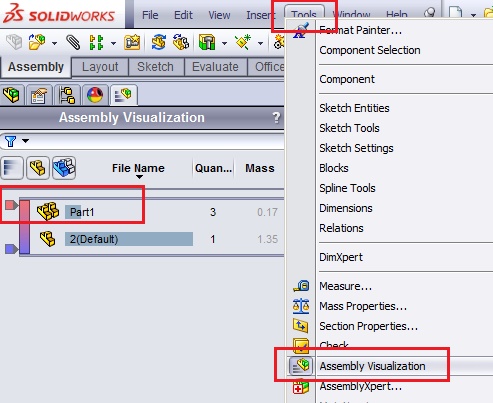

You can also take advantage of assembly visualization tool.
