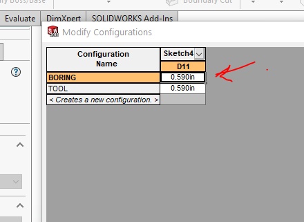

However what I want to do is have two configurations. I have one dimension. In one configuration I want to use the result in the global variable test above which will either be "A" or .1. In the other configuration I want to use another number, say .5.
I thought this would be simple as I would just go to "Configure dimension" and in one place I would put the global variable and in the other place I would put .5. Turns out however, unless I'm doing something wrong, you can't use global variables in the configuration table.
