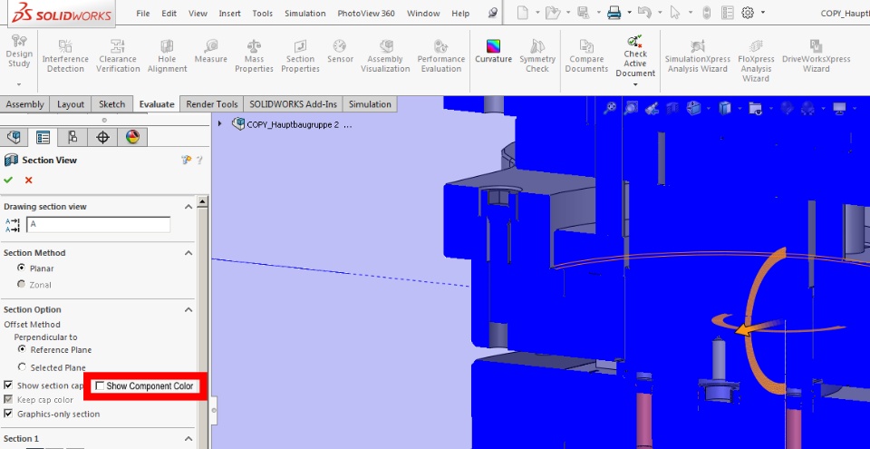

Section View to display Component Color
What still bothers me is, that, during a section view, one can only see a blue (or whatever color you set up) ocean of components or empty-"see-everything-I-don't-need"-parts.
Would someone else appreciate, if SolidWorks would show the components true colors during section view?
I'd like to see this option (see file atatched) in the near future! And then, when moving the section plane, it would show the components colors!
