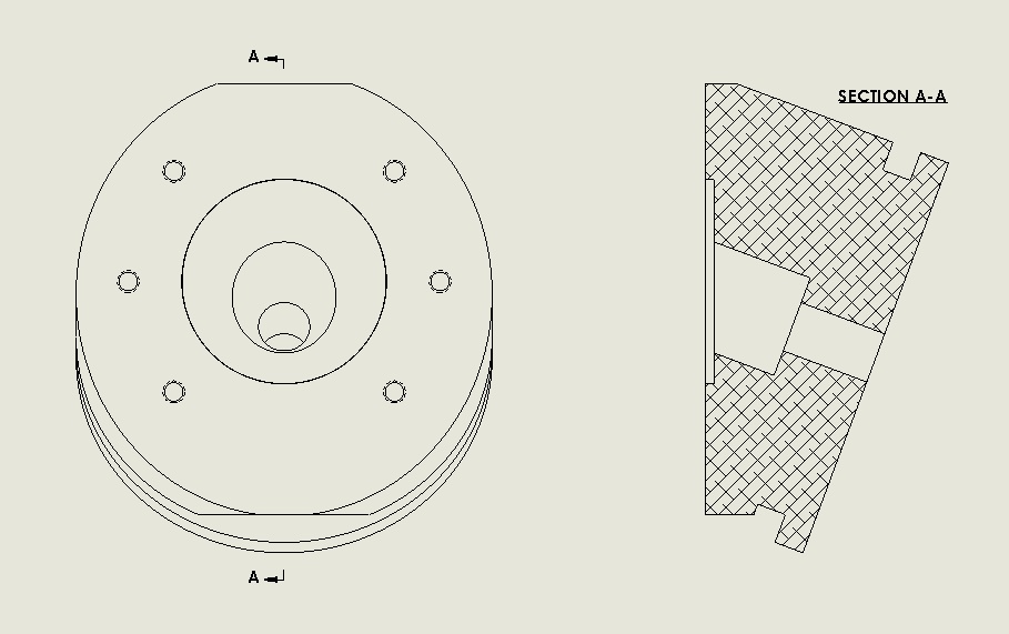

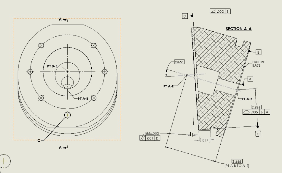

I am having some issues with drawing section views relative to an angled face.  I create a "new view" relative to the face every time the angle changes but name it the same as what is in the drawing so it overwrites it.  I "pack and go" the drawing of this model so I don't have to redo all the dimensions and view, but its not working and is getting time consuming.  Not sure if there is a better way to do this, but my section view doesn't stay vertical and want to rotate the sectioned view.  This is hard to explain, so i have added some pictures.  Model A and Drawing A are before changes.  Model B and Drawing B are after the change.  The "Cylinder with cut Face" just shows what the part looks like.  If I need to give more information I can.  Any help would be greatly appreciated.

The model and drawing is added.  It is just under part1.  Probably should mention that I am using 2014, no service packs.

I am confused as to why you are not using the Front View in the drawing as a starting point, and take your Section view from this (Front view)?

I would, but the front view doesn't contain anything I need to show in detail.  I added a couple pictures of what I am actually working with that have been modified to not show all details.  I just posted the stuff before because I was just trying to see if it was a small issue, easy to fix.  The pictures that is "Attempting" shows what happens after the change, and the "Before change" is prior to the angle/view change that I need to keep consistent.  The views shown are the areas that need to be dimensioned and shown in better detail.

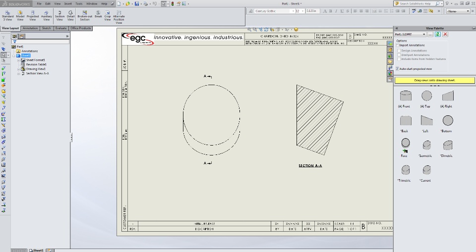

That's how I have the the main view.  That face, that is at the angle, is a custom view I save (normal to that face).  That's why I don't get why it gets rotated slightly, it's odd.  The only thing I can think of is that, when I change that angle of the face, the section view gets confused.  The section view is locked vertical and to the model origin, which in theory shouldn't change.  It looks like the section view cuts through the part at an angle, and I can't get it to rebuild (I guess) correctly, I even force rebuild and nothing.  Not sure if there is a sheet triad and a model triad, so to say, that shifts.

Your custom view for your main view is breaking.  Custom views do not remember relative to a face, they remember a position relative to the origin/main planes.... I think.  So, I may be able to tell you why it is breaking, but not how to fix it.
Workaround thought #2.  Create a side view in the drawing to project the main view off from, then create the section view from the main view.  You may have to manaully rotate the side view when your angle changes, but the other views should then update appropiately.  Kind of the same thought as doing the section view as a broken out view, and rotating the broken out view manually.  To rotate a drawing view manually, you use the same rotate view button as in parts and assemblies, just select the drawing view first.

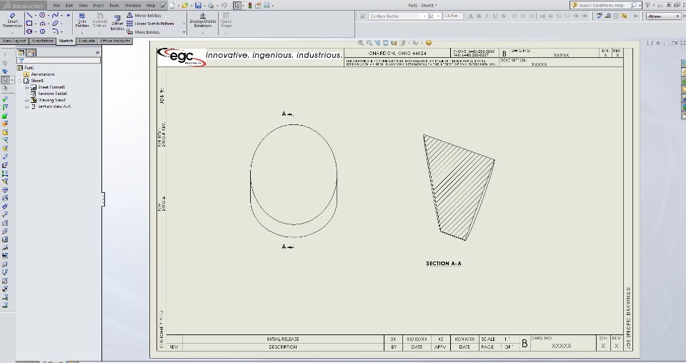

I tried to do this, or at least what I thought you were talking about, and it somewhat worked.  I used the standard top view, sectioned it (hide the top view), and then did a view projection of the face.  When I rotate the section view to to be vertical, it rebuilds, but removes all my dimensions, and I have to redo everything again.  I was hoping to not have to do this, as it is long and tedious, but maybe there is no way around it.

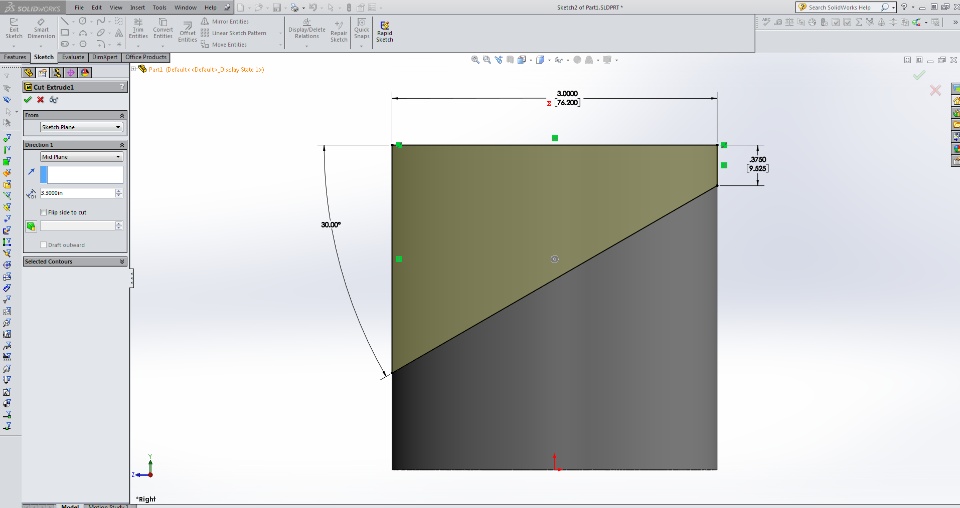

Ok Ryan - It's been a day - following pics is how I would approach it, not that difficult with just a little work around.....
First insert top view
Then add section line
Add Section View - Add vertical construction line and dimension angle
Rotate view by amount on dimension - either + or - Dimension
Delete dimension and line
Might not be the answer your looking for - but this take only a few minutes and you can get the view you need

Thanks John, but this doesn't work.

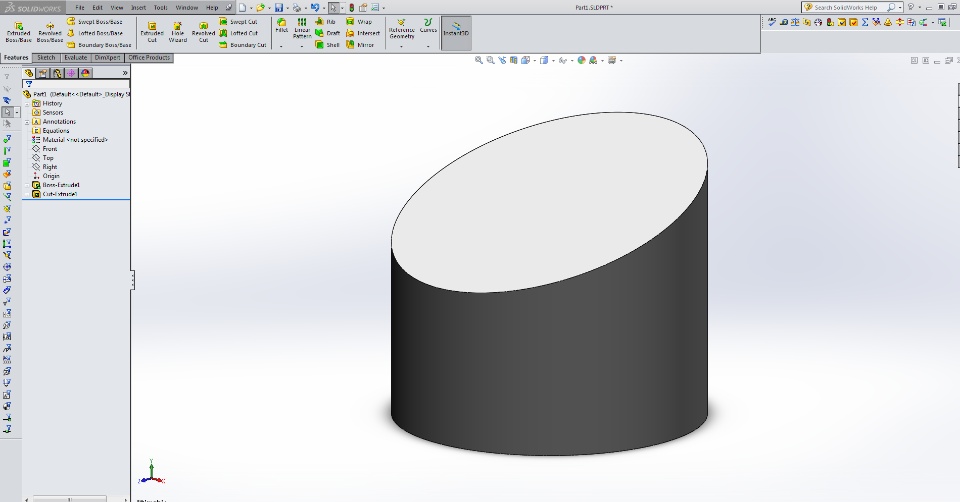

That's what I tried, but because of some complicated sketch the model, I need to show some in the drawing to provide better information. So when it's changed like that, the sketch gets rotated, and I properly show what is going on.
In all reality, I think, it just need to be modeled better/correctly.  I will have to start over with it and see what is the best modeling practice for this application.  I was always taught to model how you want it to look in the drawing.  I didn't start this job, just acquired it.

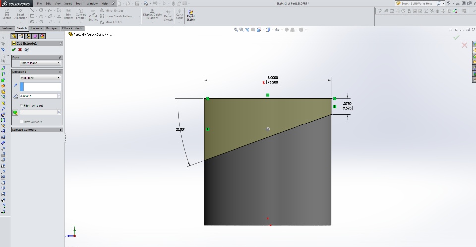

Yeah, I think that's what I'm going to have to do.  Just need to figure out how to create the model with that face on as the top plane (prefer).  The biggest issue in that there is a small cavity on that face that is offset, up the face, relative to the origin.  This is the most critical dimension.  So I would have to create an ellipse, wouldn't know the dimensions, and extrude it at an angle to create a cylinder.  (Hope that makes sense)  added picture

This aligns the view, but doesn't reset the section cut (view).  What happen, from what I can tell, is the section cut actually is cutting the model at an angle and no longer is cut vertical to the origin.  I have tried to use "3D Drawing View" to manipulate the model in the drawing, but is still cut incorrect.  For now, I am just working with it, and will remodel it later to be correct.  Or at least what I think is correct.  Thanks for the suggestion!

There is a way to do this.  It does require an extra part, though.  Create a new part (called part2 for reference).  Insert Part1 into Part2.  Make sure that you bring in the solid model, all sketches (absorbed and unabsorbed), and the planes (you'll probably need the to constrain the part, but not necessarily).  Also, make sure that the locate part checkbox at the bottom of the property manager is checked.  Then, add constraints to align the face that you want as the front view with the front plane in Part2.  Create your drawing from Part2.  Now if you change the angle in Part1, the views update and the dimensions align correctly.

To create the view is easy.  Just use Relative to Model view.  However, if you modify (or intend to modify) the angle in your example, this will not work as Relative to Model is set-it and forget-it.  It will need to be recreated each time, which may not be a desirable workflow.

I was trying it with a side view.   With a section view it doesn't work.   For some reason, the section view screws up.  But the side view works perfectly.
With a section view:
After the change with the section view:
I tried 4 different ways of defining the section line, and all 4 ways give the same result.  For some reason the section view screws up.
