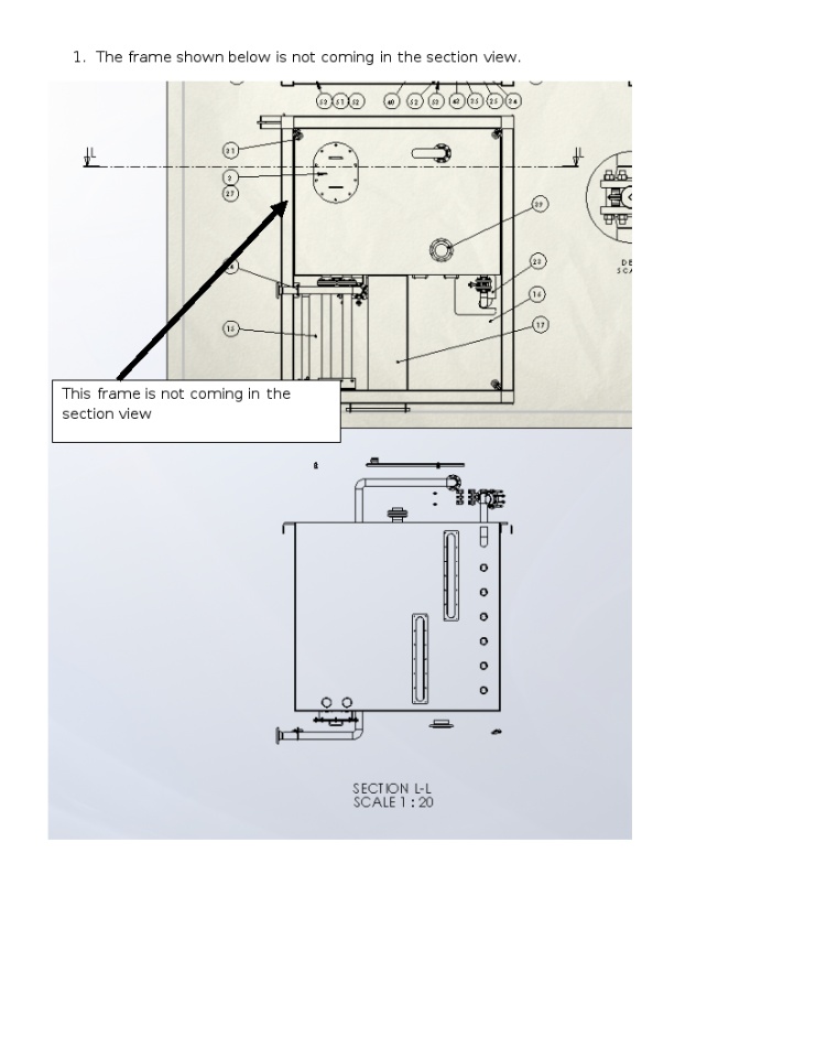

Section view problem....can any one help please?
Hi all,
i have a problem with section view in drawing.
i attached a word file, explaining the problem.
can any on go through it and help to find a solution please?

DG 2010-07-15 Best Answer
  1. Right-click the drawing view and select Properties.
  2. Select the Hide/Show Components tab.
  3. Make sure that component is not selected in the Hide/Show Components list.
The external reference is missing for that part. Fix that and check.
If all above doesn't help, kindly attach that particular part.

RD 2010-07-15
Odd.
-Did your section view somehow get set to display a different display state from the display state in the parent view? Right-click on the section view, select "properties", and see (on the "view properties" tab) what is selected as the display state.
-Or right-click on the section view, select "properties", and then look at the "hide-show components" tab and make sure the frame is not listed to be hidden.
-If not those, sometimes Ctrl-Q helps fix incomplete drawing views
