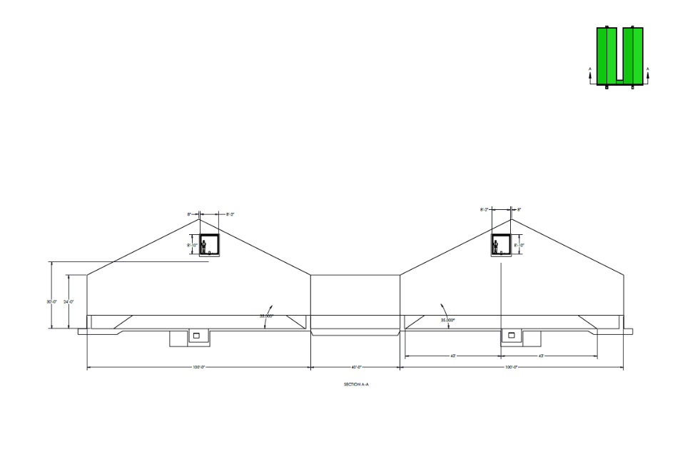

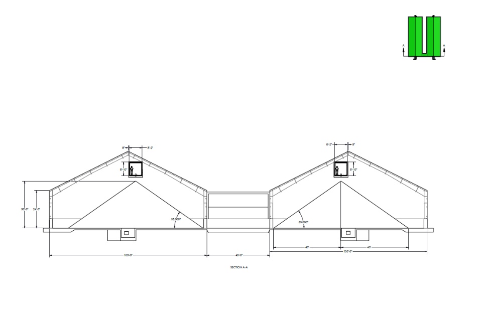

I am having issues with a component not being sectioned in a section view. The odd thing is that it worked less than 24 hours ago. I have attached two screen shots showing the issue. The building is a multibody part and is not sectioning. I have recreated the view and created the view in a completely new drawing file. I get the same results. The building part will section if it is not in an assembly. Everything sections as expected in the assembly but it will not display properly in the drawing.

It sections fine in the model. No errors.

Ok so this does sound like some true weirdness, especially since the bottom of the triangle thing is drawn, but not the top.

Just to add some confusion. I left for lunch and closed everything down. Opened it back up after lunch and it was fixed. I had already restarted SolidWorks 5 or 6 times. I even rebooted the computer.
