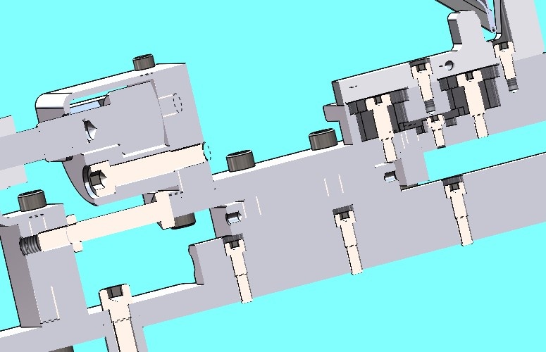

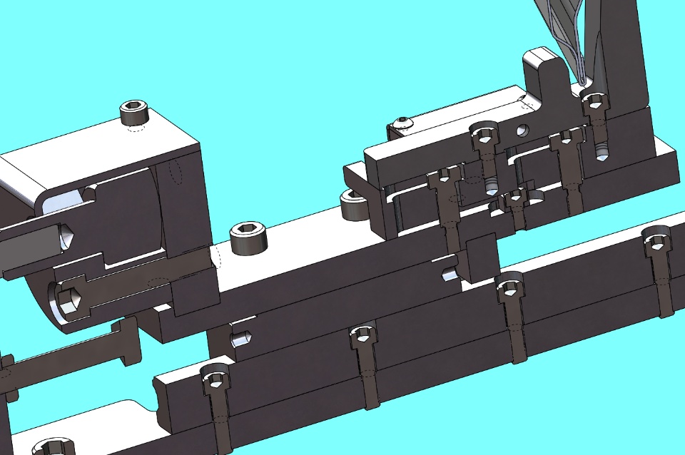

section view display problem
Why does my sections look as if the parts are merged?
Did I change a setting, if so I can't find it.
Appreciate any help.
Thanks
Top picture added to show how the section should look like.
I've checked all the view settings between the two computers and they are the same.
What am I missing?
Bad video card maybe?
Thanks again
The top picture was just added as you can see it looks correct.
It is from the same computer as the bottom picture.
The top picture is from SW 2018 and the bottom is from SW 2019.
The video card is not the problem it must be a setting change I'll keep looking.

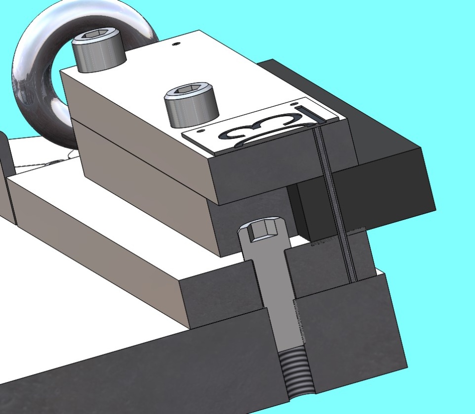

What happens if you turn this off?
comment imagecomment image
JF
JF 2021-03-26
uncheck "graphics only section"
BB
BB 2021-03-26
I see I have had that happen serval time almost always when a step files opens as a surface not a solid and you are trying to see a section through a part clamping feature of a clamping fixture.
I will give that option a try it has to be better than no section.
JF
JF 2021-03-26
the option is for when SW cannot generate the actual geometry needed for cutting the model at your requested cutting plane. (i.e. if you have a cylinder tangent to the cutting plane).
BB
BB 2021-03-26
Jeremiah that is the setting I somehow changed.
I can't imagine why you would want to use that setting.
When viewing in the hidden line mode it is totally useless.
Thank you
BB
BB 2021-03-26
Both computers look like this.
