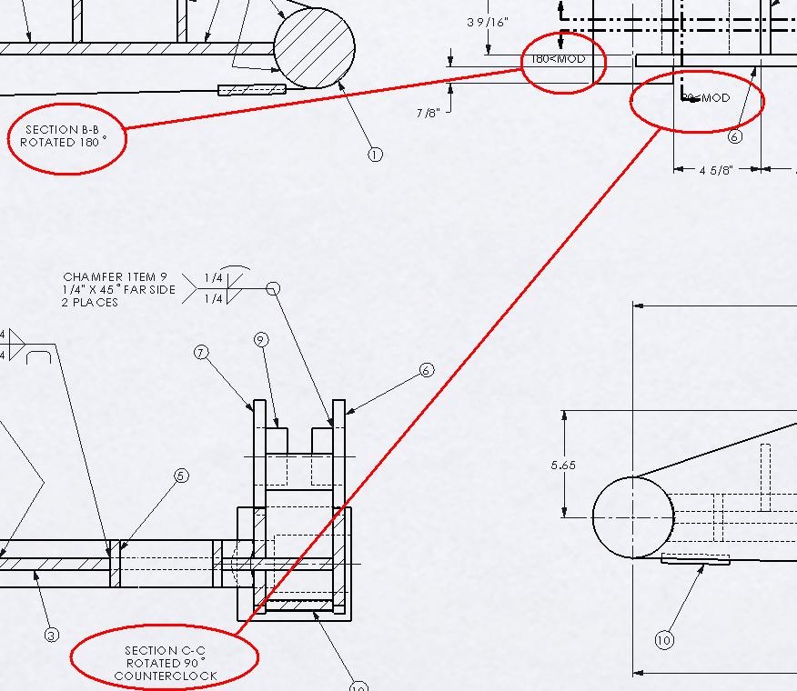

... ahh, this never-ending nonsense that they call a "drafting package"...  I've got two section views in this drawing, and I've modified the text of the section views, as they've been rotated and this needs to be in the name.  Unfortunately, SolidWorks has decided that I also wanted to change the name on the section line to "90SolidworksDrawings And Detailing

oops, forgot to post the screenshot...

well, shoot, I think I found the answer to this one, too... if I make the view label name a "manual label" (one of the options in the properties), the problem SEEMS to go away.

Dear Ed,
I've been through this before and unfortunately the answer for now appears to be to type the angle notation as a separate note and try to keep them together manually as you go. Maybe linkable in next release if we request.
Best wishes,
Bernard

Ed,
Alternately you can try setting the view label to a blank entry, and then add a manual note to the view.
Just did this yesterday when something similar came up.
I wanted the label to say
SECTION A-A
SHOWING THIS
THAT AND
THE OTHER
or something to that effect...

Ed,
In the property manager there is a selection that allows you to overwrite the default label
Solidworks gives you.  I think this might give you your best control over the label.

You don't have to "try to keep them together manually".  You can group the view label with your additional note as long as you make sure that the note "belongs" to the view.  If you create the note near the view label, the note will actually be placed on the sheet and will not "belong" to the view.  You can verify this by moving the view - the note will not move.  If the note does not "belong" to the view, you will not be able to group it with the view label.  Once you create the note on the view, you can move it down to the view label and it will still belong to the view.

Josh,
You're a champ! Yes, I've tried it now and that does work. Getting the text in the same view was the critical step. Then you co-select the text strings, right-click, and pick "group".
