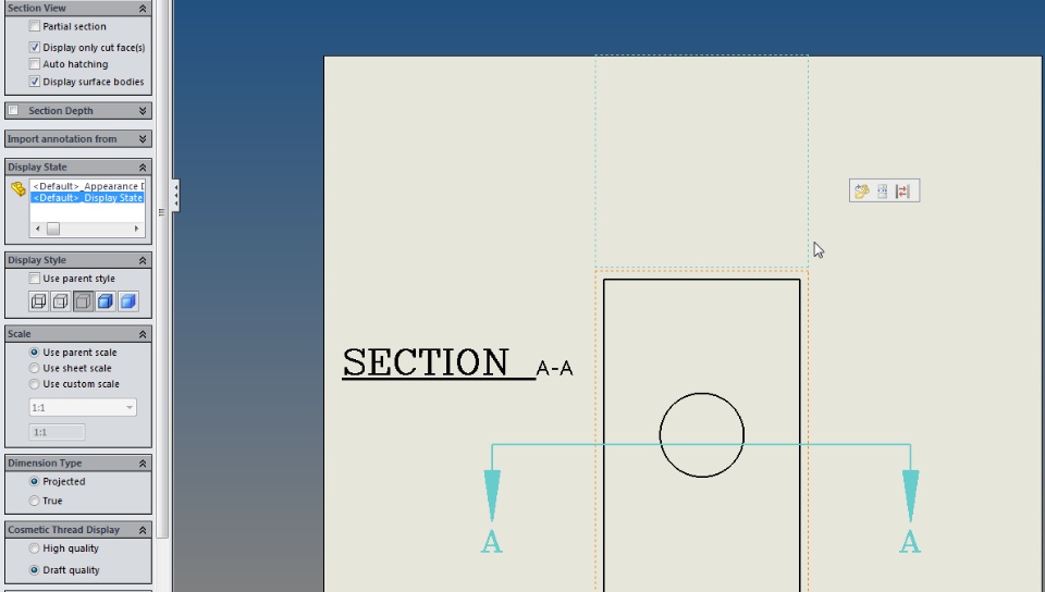

Section cut on a surface body with (Display only cut faces) option is selected, does not work properly. Just showing blank view.

I suspect that it is actually working as intended - since you told it to display only cut faces, and there are no faces made by the cut since it is a surface body.
Hi Jakob,
The option to section surfaces with this option "Display only cut faces" is a current limitation of this section surface functionality as obviously you would expect to see the line(s)/spline(s) entities as sectioned/sliced though the plane.
Surfacea are really just faces, so they should show the intersection at the surface
There should be no difference between the section of a surface block compared to a solid block
Your almost there Don, I know you guys will have this fixed for the full release?
A true section only shows items at the intersection, haveing this limitation will show a ton of unneccesary geometry behind the section & NOT be useful
