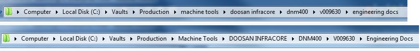

Currently running Enterprise PDM 2012 sp1 and have noticed when I search (either with the built-in search tool or the pop-up search tool) when I 'browse to' my location or 'browse to new window' the path in the explorer window has defaulted to all lowercase.  This may not seem like a big deal but it actually messes with my macros and rather than try and work an exception into the macros I would much rather try and find out if there is a solution to this within windows.  I am running Windows 7 but can confirm that it does also happen in Windows XP.

Can you post a screen shot? I just took a look at mine and I have normal case - or whatever the user inputted.

Sure thing, the top shows what it looks like when 'browsed to' after a search, the lower is what it looks like if I manually browse out to the same location.

I see now what you're getting. Odd that my Vault name doesn't go lowercase, just the child folders. This may need to get reported to SolidWorks as there aren't any settings.
If you go to an assembly's BOM tab and RMB on a component > Browsw to opens a new window with proper formatting.
If someone with 2011 running could check this, I'd be curious if it's a regression.

I think your best bet is to use LCase() (or whatever the function is for your language) to convert the path to lowercase before comparing it. One can not control what users are going to do with file and/or folder names.
