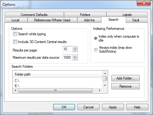

When I went into SW Explorer > Options > Search tab and added directories to search in, I hit Apply then OK.  If I go right back in to the search tab all the directories are gone.  What gives?

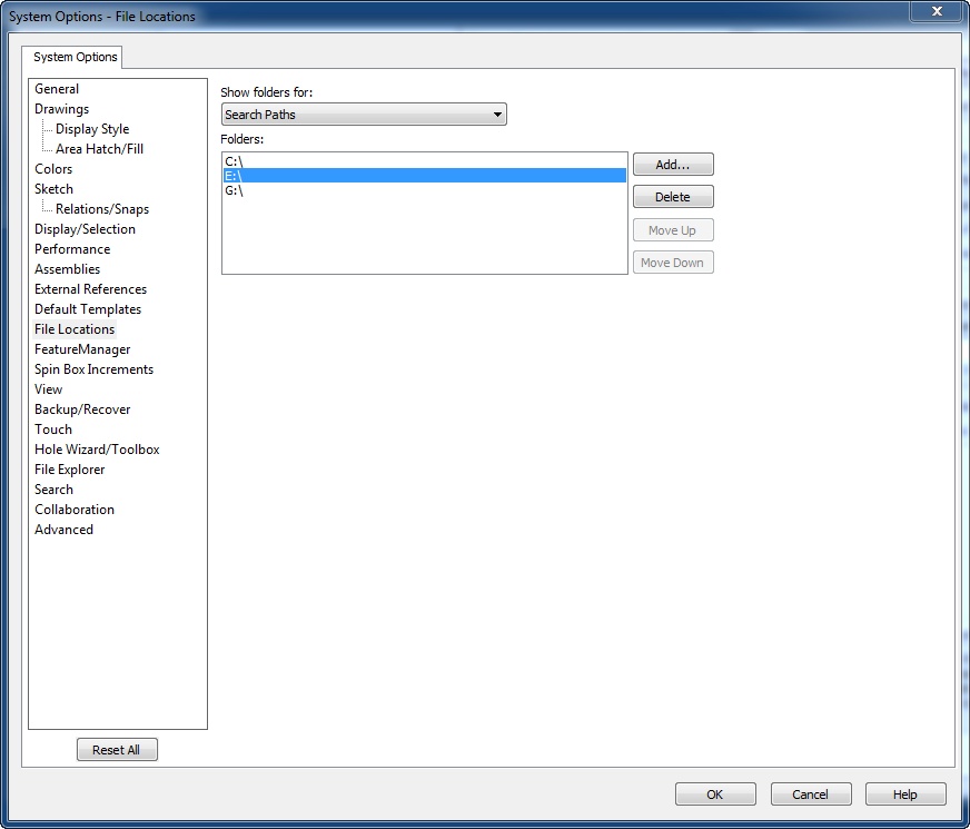

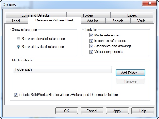

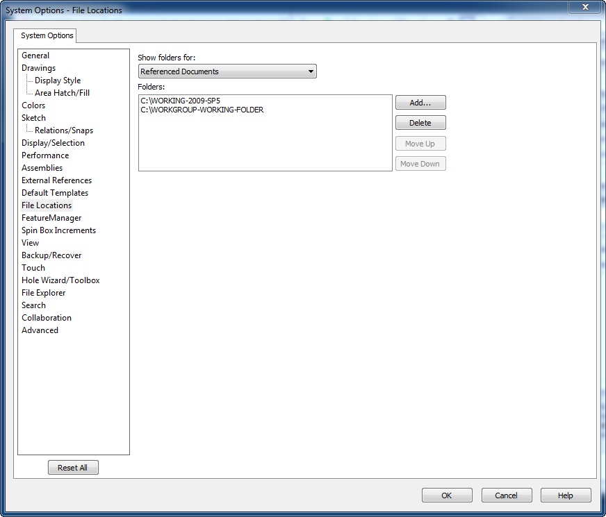

Attached are the 4 settings I recommend you look at, 2 in SolidWorks and 2 in SW Explorer;

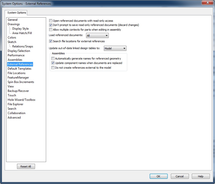

One more attached, from SolidWorks

Devon,
  1. I don't have folders like these.
  2. They disappear the same as SW Explorer search paths
  3. This is what the original post was about (see 2)
  4. Tried that, no help
  5. I have those settings

We just went through this problem at my work with the search paths.  SolidWorks uses Windows Desktop Search for its search tool.  Windows Desktop Search is built into Vista and Windows 7 but will need to be installed on XP.  If you don't have WDS installed then nothing you put into the Search Paths area will stick.  Once you do have WDS installed any folders that are explicitly added to WDS will show up as search paths.   The 32 bit version of desktop search seems to work better in that it allows you to add and remove indexing from shared drives.  The 64 bit version does not seem to allow either task.
