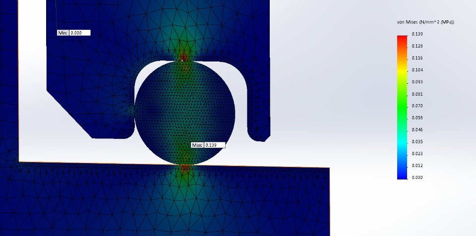

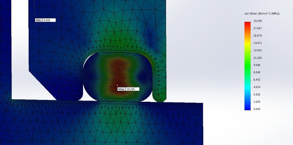

I've perfomed a non linear simulation of a valve seal compression.
These are the results.
Before compression:
after compression:
