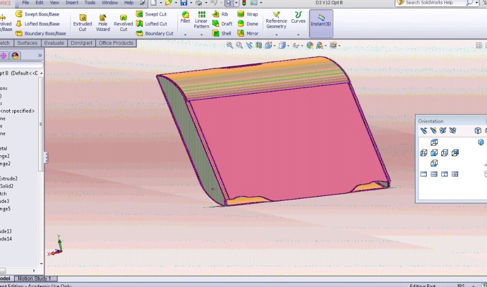

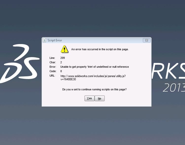

Hello,  I just updated my version of Solidworks from the 2010 student edition to the 2013 student edition. I keep getting a "Script Error 209" when I run the program. My IE and Java script are up to date. I found some discussions on other script errors but not 209. I was hoping someone knows what's up. I'm not into the psychodelic colors the program gives my project while I'm modeling.
I'm running Window Home 7 Premium 64 bit , 8GB of RAM, hard drive space for days, and an Intel i7 processor 2.20 Ghz, Intel HD Graphics Family 3000.

How did you do your update?  An upgrade or a complete uninstall, clean the registry and re-install SolidWorks?
Your display issues are likely because of the non-approved onboard video your system has.
There is an approved list of video cards and drivers for SolidWorks.
http://www.solidworks.com/sw/support/videocardtesting.html
Have no idea about the 209 script error.
