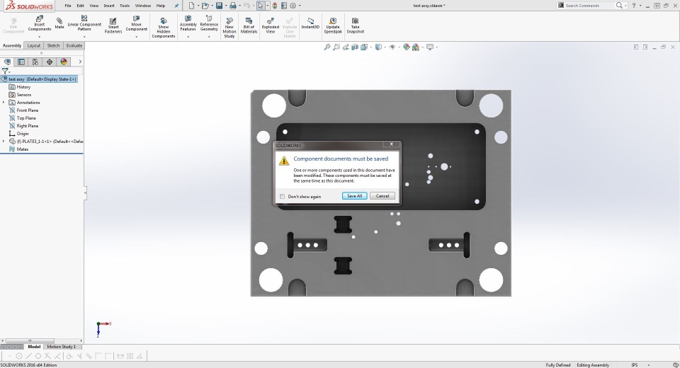

Ok I am going to attempt to word this correctly.  Sometimes when saving a part in an assembly I can save as an parasolid or step etc. and it gives me the option to save just the highlighted component.  When it does that's great and works perfectly so that I can detail just that plate or component. A lot of files I don't get that option even appearing when I have just one component visible and highlighted and it still wants to save the entire assembly. This is a pain and makes it difficult to make prints of just single plates.  What can I do to save parts out of assemblies separately successfully?

If you are trying to save a particular part in position inside an assembly to a parasolid, then you need to have all other parts hidden or suppressed.  Then you should get this dialog box appear:
If you say "Yes" then it will attempt to also save the hidden or suppressed items.  If you say "No, then it should only save what is shown.

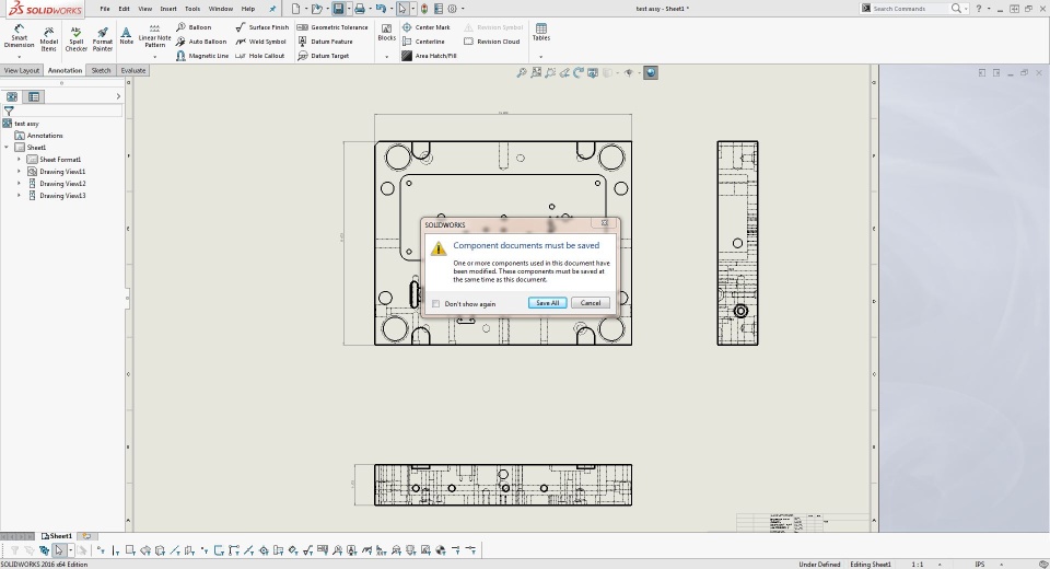

When I went to make a drawing it still asked to save components. Shouldnt it be just the plate I highlighted with no components if they were supressed?

Ahhh, I think I see the issue now.....
It looks like you have created a Solidworks part that has NOT been saved anywhere yet.
In order to create a link to that part (which a drawing is automatically doing when you create one), you need to have a file location for that part.   If you haven't saved that part, then there is not a file location yet.
You have to save it as a Solidworks part for it to register that it has a file location.  Saving it as a parasolid or a step just creates a copy that is NOT linked to your drawing.  Solidworks Drawings can only be linked to Solidworks files.

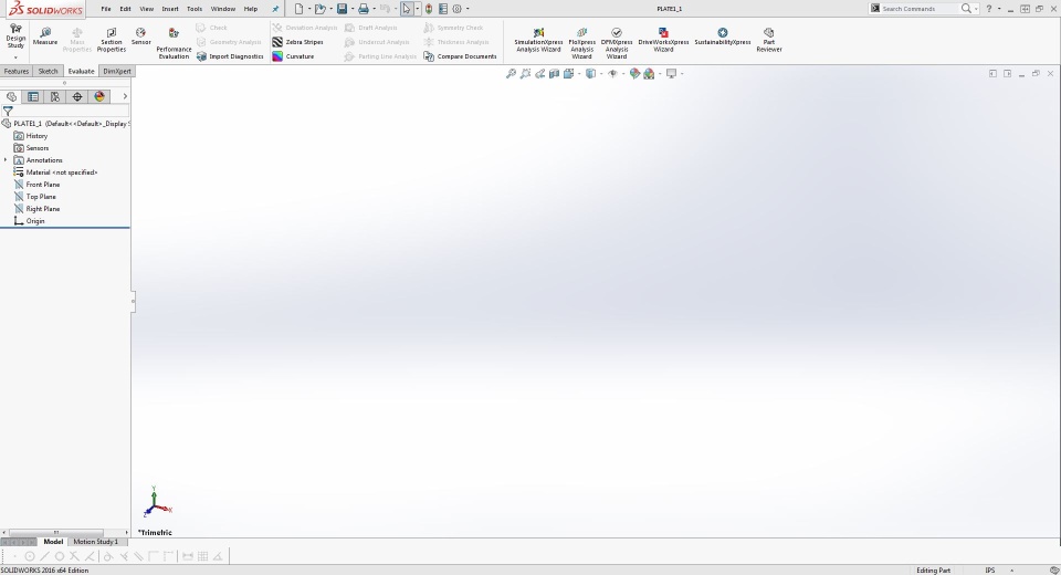

I guess the other problem is when I do initially save an assembly it does make separate part files into the folder I created. The problem with that is when I try to open that separate part nothing shows up when it is opened.  I must be doing something wrong I guess IDK

I just tried a couple parts. I did get a leader pin to show up.  But the plate did not.  SOOO weird

<p>Ben Williams wrote:</p><p></p><p> The problem with that is when I try to open that separate part nothing shows up when it is opened. </p>
I suspect that the Parts are there, but off the screen.  That happens to me all the time when I open virtual Parts to edit them.  Have you tried hitting your F key when that happens?  That should center the model in your screen.

at this point I have 2 copies of these parts in the folder   soso   and soso1.   the soso seems to show up but soso1 does not.  Before when I had just 1 it didn't show up.  haha this is sooo confusing sometimes

Ok, I tried your step file.   I am not having the issue that you mentioned with blank parts.
What I did was to open the step file in Solidworks, then run a save.  A dialog box will open asking you where to save the assembly file.  Once you select folder, then a new dialog box will open essentially asking you to save all.
This will save all the parts from the assembly into the same folder that the assembly file is in.
It is a good idea to do that BEFORE you open any parts separately OR try to create drawings.  That way, you will have all Solidworks files to work with.

When you open a step or parasolid file that has multiple bodies in it, Solidworks can open it as a multibody part or as an assembly.
If you have "Import multiple bodies as parts" checked, it will open a file with multiple bodies as an assembly.
If you do not have "Import multiple bodies as parts" checked, it will open a file with multiple bodies as a part (ONE part...with a LOT of bodies in it).
When it opens a multibody file as an assembly, it creates a file for every body in that assembly.  HOWEVER, until you hit save, those files are essentially EMPTY files.  If you are only needing some of them, and would prefer to not save all of them, then while the assembly is open and showing them...click on them and open them.  Once you have them open you can save them, and not have to save the entire assembly.  If you open a parasolid or step file as an assembly and exit without saving, you have nothing but a bunch of empty files.
