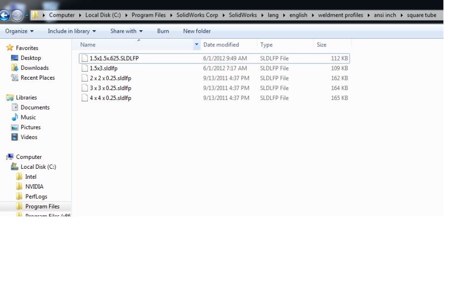

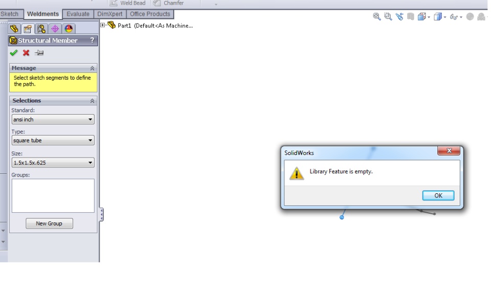

Ok so I was able to move the file into my weldment folder location. Then I check my weldment profiles and found that it did read that there was a file of what I made. But when I went to apply the weldment it then said that folder was empty. So we are getting closer I just dont see why it said it's empty? Any ideas?
SF
SF 2012-06-01
Ok so I took some SS of what it looks like on my computer. In the first folder it shows that it is in my weldment folder with the size located and everything. The second SS shows that it is then showing as a selectable size in the weldments in the actual program SW. The third SS shows the error saying that there is nothing there. Which makes no sense because it opened before I moved it into the weldment file.
DG
DG 2012-06-01
The first two SS shows that you got he file in right place. Third shows that there is no sketch in you profile.
To check, open the weldment profile you've made and make sure there is an L mark on the sketch in the feature manager.
GS
GS 2012-06-01
To elaborate on what Deepak just said, if you don't have the sketch selected so that it's highlighted when you save it as .sldlfp then it won't work.

Ok I finally found the solution. I forgot to right click the sketch and add to library. I had no idea that you had to add it to the library that way. I thought once you saved it to the file you were good. Now I know why you asked me about the L on the sketch Deepak. Sorry for that didn't really know what it meant. But there is still something semi wrong with my windows not allowing me to directly save into solidworks. I have to save it to the desktop then transfer it over manually. Oh well I'll take it haha. No more headaches from this yay! Thanks all for your help!
