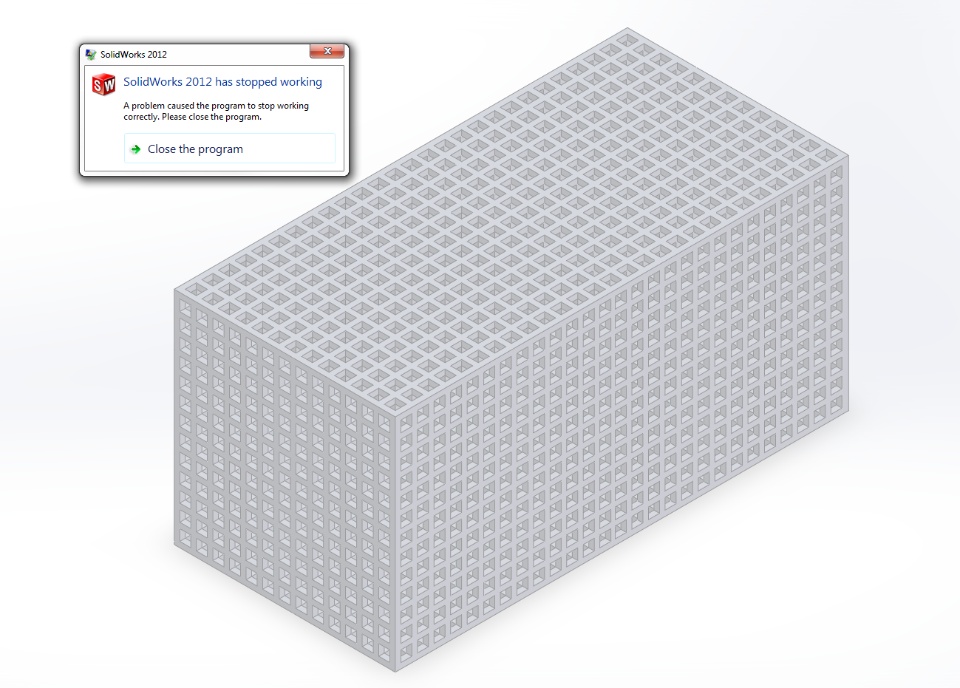

Save PRT file as STL.
I am using SolidWorks 12.  Trying to convert a part (below) into an STL but it keeps crashing the program. Any suggestions would be much appreciated?

DE 2021-04-09 Best Answer
I would take a look at your export settings. Try setting the Resolution to "Coarse" and you may want to turn off "Preview before saving file".

Suppress all the features, ctrl-q, then save-as.  If I remember right, save-as will remove cached body data so the file will be much smaller.

Frederick... I remade it for fun in 2014.. it's 53 megs and holds 131820 triangles at lowest res.. the STL export at low res is also ~130K.... it brings SW down to a crawl  ("IF" you do not reduce the Resolution to LOW and turn OFF Previews)................... but, I can export it. (attached)

I have tried lowering resolution as well as no preview before saving file and still doesn't work.  The full file is 42 MB and will not fit.
