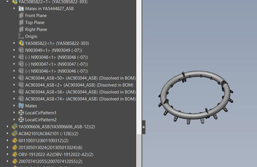

Save assembly with isolated parts
 I need to select just some parts in assembly and save the assembly as step/iges. When I select those parts and use command Isolate,  the rest are hidden. I save the assembly but it saves all parts in assembly, even when I click no to question if it should unsuppressed parts.
Is it possible to save assembly with just isolated parts?
